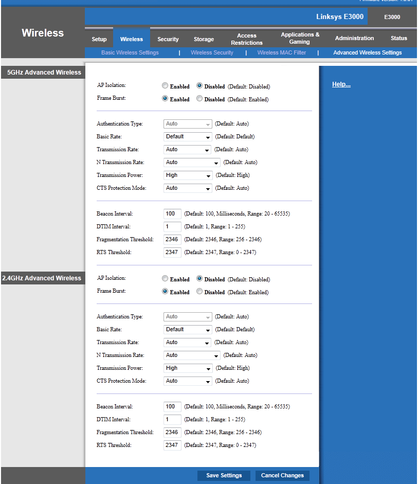

  3. OKAY, to isolate the issue... I setup a smart gigabit switch and only connected the laptop and gaming PC... both have gigabit Ethernet ports... and the transfer rate is at 50 MB/s.... I am unsure what the transfer rate SHOULD be but I still think this slow, am I correct? Also... here are the wireless settings on my router... Although I still think its windows related...
Name:	advanced wireless settings.PNG
Name:	Wireless settings.PNG

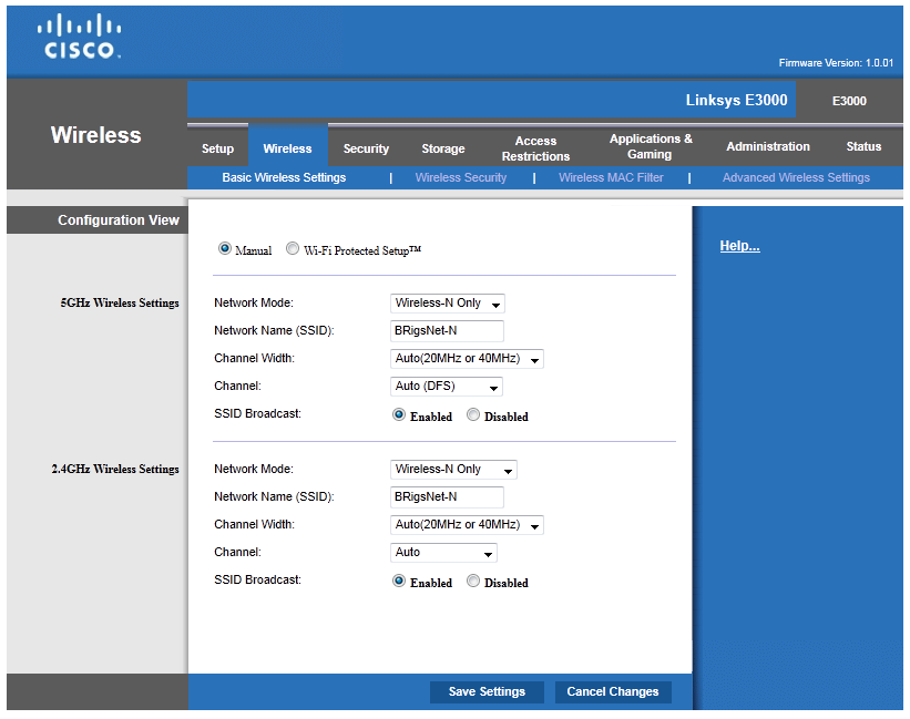

  4. Here is another..
Name:	basic settings.PNG

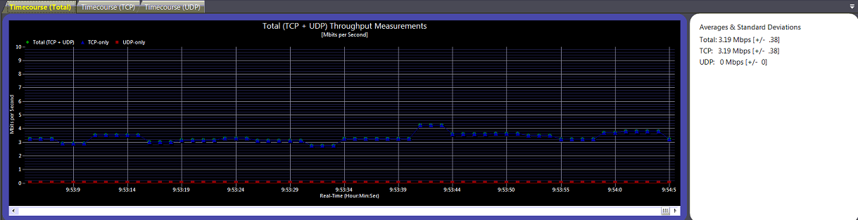

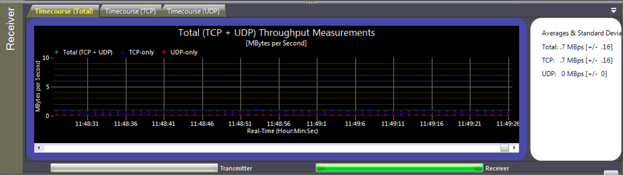

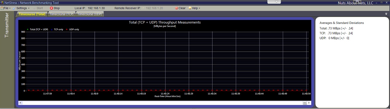

  14. Here is the results of the NetStress.... over 2 wireless signals (gaming laptop to media PC)
Name:	sent traffic.png
Name:	recieved traffic.png

    well those results are pretty awful. in normal network mb/s terms you get under 6 mb/s throughput. any decent "n" network should be 10 times that., even a wireless "g" should be at least 5 times better. either the wireless router is bad/the adapters are bad/or they don't work together.

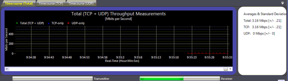

  20. Okay here is a netstress after changing the wireless from N only to G only....
    Also... jagabo.... My gigalan is fine... the speed on my LAN was actually higher than I have seen last night at 80MBps... (started at 108MB/s and slowly reduced to 80MB/s).

  23. aBigMeanie aedipuss's Avatar
    Oct 2005
    666th portal
    [QUOTE]
    Weird. You're getting better speed out of B than N.
    it looks like the reporting was changed from MB/s to Mb/s so the speed is actually lower. not that much but a little. poorer than poor?
