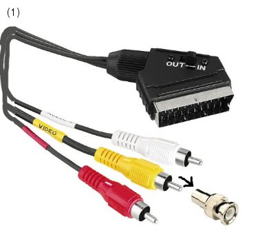

    You'd plug the yellow plug into the 'BNC to RCA' adapter - see image (1). (The white and red plugs are for audio and can be ignored.)
    and if possibly where to by it from.
    You can get them from Amazon - although you might end up buying from Amazon Marketplace sellers rather than directly from Amazon. Maplin also sells adapters:
    http://www.maplin.co.uk/phono-to-phono-video-lead-9619?ordercode=L45BA
    http://www.maplin.co.uk/scart-to-3-phono-plugs-with-in-out-switch-28102
    http://www.maplin.co.uk/bnc-plug-to-phono-socketadaptor-1593
    *make sure any SCART adapter you buy is switchable in/out, and have it set to 'in' for your setup.

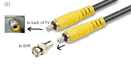

    It looks like your TV also has RCA video input. If you can see a RCA socket labelled as 'Video Input' on the back, you could substitute the SCART adapter for a simple male to male RCA cable - see image (2):
    http://www.amazon.co.uk/VASI4KO-Single-Phono-Cable-Composite/dp/B004M640C2/ref=sr_1_1?...8678657&sr=8-1
