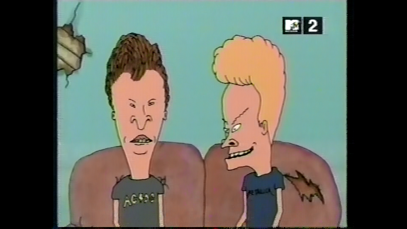

    Currently, I am working on and off again on a archiving project near and dear to me; getting all my Beavis and Butthead tapes (recorded off various broadcasts) to DVD-R.
    I have been using a TOSHIBA DVR 620 to make the transfers (always using the highest quality setting). However, after reading up on a few things here, I am wondering if I should use a different route? Perhaps getting a JVC prosumer VCR with built in TBC or something of the like??
    The tapes are not the best quality to begin with, with VHS being lossy and the occasional analog artifacts inherent in over the air broadcasts. Below is a screen shot taken off one of the DVD-R transfers I made. The original VHS was made on a 4 head RCA Hifi VCR (model number is a mystery to me) in EP mode some time in the mid 2000s from a satellite broadcast. I am unable to get a capture of the actual VHS on to my computer at the moment since I don't have the means of doing so, so I'm not certain if there is any further degradation of the picture inherent in the new DVD-R transfer I made. I compared the two back to back on my TV, and surprisingly, the DVD-R seemed to retain the same quality of the original VHS.
    However, the Toshiba unit does not have any sort of filtering or sharpening mechanisms for the VCR playback and more of the "quick and dirty" type. Would it be better to try another VCR to act as the playback machine or is it possible that I can simply rip the DVD-R transfer to my computer and clean it up using a type of software?
    Sorry if my questions come off as "noob-ish" to some of the more polished experts. I guess you have to start somewhere. Any help is appreciated!
    Here's the screen cap as promised. As you can see, there's various degrees of blurring and halos along with some analog 'noise'. What particular software and/or fixes would some of you suggest?

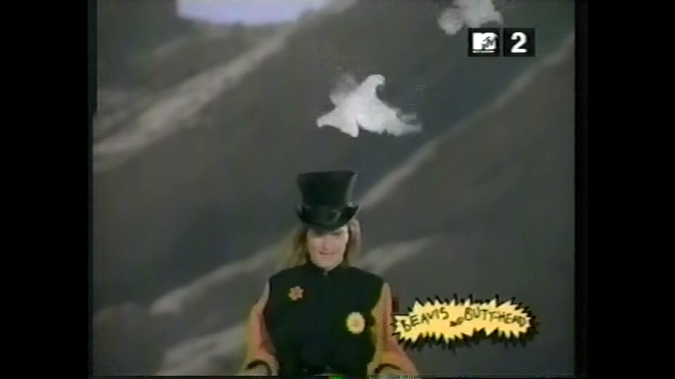

    Here's another screen shot from the same segment as the previous one for posterity, this time of the non-animated portion.

  6. You can get better quality if you want to spend a lot of money on hardware and don't mind spending a lot of time learning. An SVHS deck with a line time base corrector, a full frame time base corrector, and an analog proc amp. Then capture draw YUY2 with a lossless codec like HuffYUV. And finally some advanced filtering with AviSynth.
    Post some samples of your current caps. Someone will probably give you some filtering options. DgIndex is a good choice. Open one of your VOB files, mark a short section, then Save Project and Demux video. Post the M2V file. Cartoons are especially amenable to cleanup.

    Judging from the images, you won't get the quality you're looking for by recording directly to DVD. VHS almost always needs more help than you can get from filters on a DVD recorder. Your best bet is to capture to YUY2 AVI onto a PC's drive, and learn to use VirtualDub and and/or AviSynth and a good MPEG decoder. A lot of the software you need is absolutely free.
    I wouldn't recommend a JVC with onboard TBC. Legacy VCR's at this late date are mostly in poor repair. Parts support for the better VCR's from the 1990's is nonexistent. A full-frame outboard TBC could be useful, but a line-level TBC is almost essential for VHS. You can get a Panasonic or Toshiba DVD recorder (used is OK) and use their built-in TBC's as a pass-thru device -- that is, connect your VCR's output to the recorder, but instead of recording you send the recorder's output directly to your capture device. If you're using a Panasonic machine, their TBC is active only on Line 1. IMHO Toshiba gives the best results, to the point where often I don't need my full-frame TBC in the circuit at all except for really scroungy tapes.
    A proc amp isn't absolutely essential (I love my SignVideo PA-1), but a good one is pricey. Never go for cheap $100 proc amps you see in big box stores; you can do better work on your own with free software.
    I don't know if you've seen the popular digitalfaq website yet, but try some of the guides in the left-hand index on this site: http://www.digitalfaq.com/ . Many in this forum got started there. If some of the tools mentioned seem a bit dated, remember that many people still own and use them. Topics are frequently updated.
    One remark about sharpening during capture sent a shiver up my back. Don't sharpen VHS until you've denoised it. If you sharpen during capture, most of what you sharpen will be noise; getting rid of it won't be at all easy.
