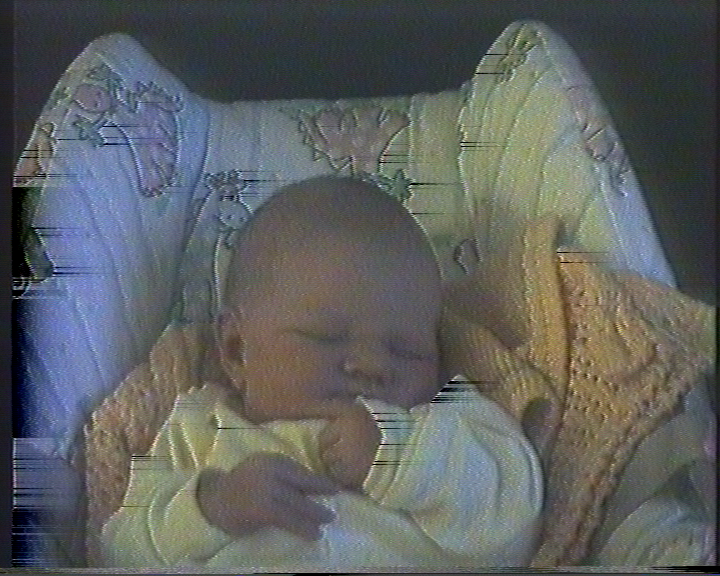

  1. I have just transferred about 25 VHS-C tapes filmed with the same camera bought in the early 1990s. The owners used it until about 2003 when they bought a new one.
    Two tapes I've found with similar problems. On the tapes where the problems appear they are not there on all scenes recorded on the tape.
    Every scene or group of shots taken during the same day act as one of the following:
    1. Looks like any other material recorded with the camera on any of the other ~25 tapes.
    2. Have these fading black horizontal streaks around high contrast edges.

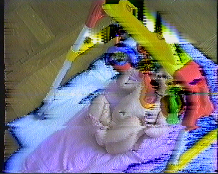

    or...
    3. Looks like this with the black horizontal streaks and something that looks like black or white flames coming from some areas.
    The problems appear on all machines I've tried so far. they look about the same on my Sony, Panasonic and Philips VCRs On two Philips machines the scenes were these artefacts appear also have tracking and colour issues.
    As it seems to be problems with the recording or the tape and I don't have the money to get professional equipment to combat the issues on these 2 tapes I'm trying to find a filter solution to mask these artefacts. I know it won't be pretty in the worst scenes but at least some scenes will look quite okay especially the ones with just the black streaks.
    Any idea on filters that might fix this without altering too many "good" pixels

  2. If you can't do a better transfer or a hardware fix , or the problems are on the tape recording themselves, a software method will depend on the distribution of artifacts. If the distribution is random and differ between fields or frames then you can use motion compensated scripts and filters to fill in the defects. Most of the avisynth methods will be based on mvtools/mvtools2 . Persistent defects that exist on adjacent fields or frames won't be detected or treated
    Some functions like removedirtmc may work , or even more complex ones like one in this thread by "yup" specifically for black lines and dropouts. Of course, you would have to adjust the settings for your specific source

    Your 2nd problem is probably more difficult to treat. Maybe if you could upload a sample or describe how the distribution you might get better suggestions

  3. Here are three files 1 and 2 are clips of around 2 sec of 2 clips with the different artefacts encoded with lagarith.
    the third file is a mjpeg of the same two clips (both).
  4. I'm trying to wrap my head around yup right now. it looks like it may help with the black streaks
  5. Yup filterchain does remove some lines but does not work where more than two lines are adjacent. I'll have to continue tomorrow after some work and some sleep.
  6. As mentioned earlier, none of the Motion compensated filters will work well when the defects are persistent (in the same spot on every frame or adjacent even fields or odd fields). Only defects that are randomly distributed are detected and treated , so you'll find only those random peripheral dropouts will be filled in fairly well.

  18. Originally Posted by MadMax_911 View Post
    [Attachment 7490 - Click to enlarge]
    or...
    [Attachment 7491 - Click to enlarge]
    [EDIT] Forgot to say that one of the problematic tapes were made in 1995 and the other in 2000 and all tapes were made with the same camera and it were never repaired and the tapes made between the tapes with errors played fine.
    I believe that this may be either a faulty sensor or recording function in the camera - the overscan shows no issues yet the issues seem to happen in the same places. I believe a line TBC with noise reduction will help straighten the image and eliminate some noise but the damage is definitely done.
    My suggested fix would be following as a quick fix, though I would keep master copies as tech/avisnyth improves:
    1. crop the bad portion out on the left and balance with right
    2. deinterlace
    3. light denoise
    4. descratch/devhs
    5. resize as needed
    I am not naming specific filters because I haven't seen this before, but that corner is more or less gone. This is far from perfect and somewhat of an ugly way to do it but it will get rid of most of that issue on the first clip.
    This might be best done frame by frame.
    Software can't fix this.
    You need a better capture.

    The ragged left edge in Sample #3 suggests timing problems. My guess is that your adaptor is bogging down the transport. You may get a better result playing back in a VHS-C camera without the adaptor.
