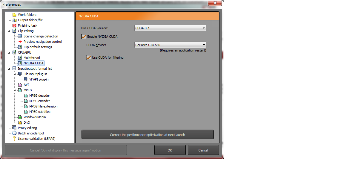

    Hi all, I recently bought a brand new Nvidia GTX 580.
    I wanted to try using it for video filtering (mainly denoising) using Tmpgenc Video Mastering Works (ver 5.0.6.38) and CUDA.
    No matter what I do, what filter I choose, the percentage of CUDA usage remains 0.0%, and CPU 100%.
    I have already enabled CUDA in Tmpgenc (see attached screenshots for all the options I set and the result)...
    The source file is an ordinary DV avi file, and I want to filter it and then encode to standard DVD format.
    Any ideas?
    System specs: Windows 7 x64, 6 GB RAM, CPU Intel Core 2 Quad Q9650, Nvidia GTX 580 (latest drivers 275.33 installed).
    Thanks!

    did you try clicking on "correct performance optimization on next launch"?

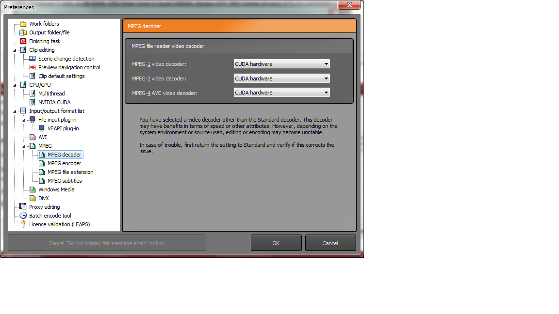

  10. deadrats> you are right! I was sitting on a CUDA enabled computer, with a CUDA enabled software and didn't know how to properly use it!
    So, after setting: option, preferences -> mpeg video decoder - > mp1, mpg2 and mpeg-4 video decoder to CUDA hardware the video card started calculating for me processor 9% and CUDA 91 percent. With my 440 GT video card, the gain in time was not so big: 3:20 second with CUDA, 3:43 seconds without CUDA (total encoding time for about 3-4 minutes of avchd media).
    It's too bad that mpg2 for bluray can't be encoded with the help of CUDA. I cannot select only the "Standard encoder" in "format" tab. There are other encoding formats that allow "CUDA hardware" as the "video encoder", as the MKV file output.\
