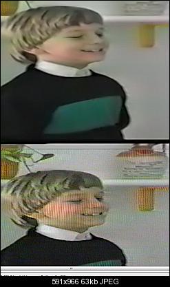

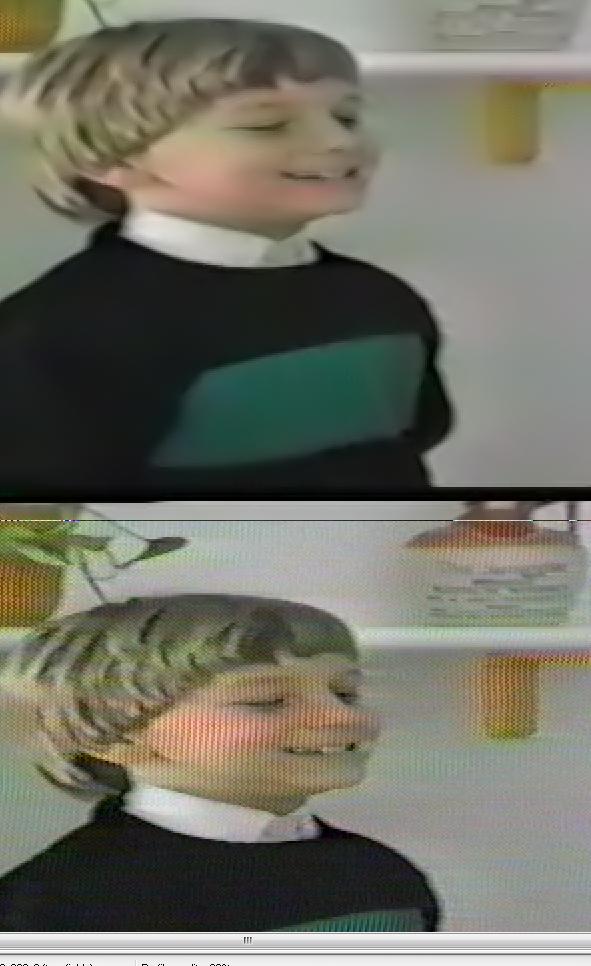

    Just to give you a better idea of what kind of noise I'm talking about, here is an example (please zoom to full size).
    I also captured the same frame without the noise just by doing the trick of changing the input video source few moments earlier. Here is the result which is quite acceptable to me.

  4. This noise is very coarse especially on the high frequencies harder to remove than i thought initially, try neat
    example:
