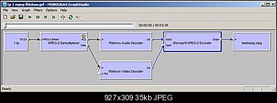

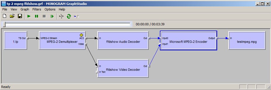

    When converting a .tp file to mpeg2, the ac3 into the ffdshow decoder is output as PCM.
    Which filter would I use - and placement - to get ac3 in the output file.

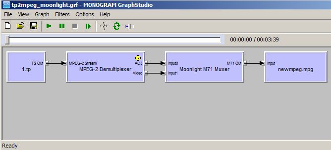

    I have used MONOGRAM AC3 Encoder. However, I would use Moonlight M71 Muxer plus Moonlight Dump POS instead of that Microsoft MPEG-2 Encoder and dump filter. What you have only accepts PCM audio.

    Great.Thank you, it worked.
    I spent hours on the ffdshow route and couldn't get it.
    [Attachment 7477 - Click to enlarge]
  4. Originally Posted by sambat View Post
    I spent hours on the ffdshow route and couldn't get it.Image
    That's because it's decoder, not an encoder. Can't you just remux the original AC3 audio into the new file?
