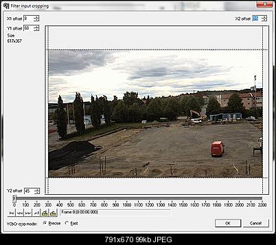

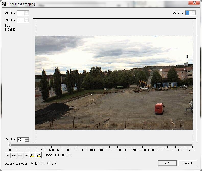

    I see the cropping regions, video->filter->null transform and cropping:
    Or do you mean something else?
