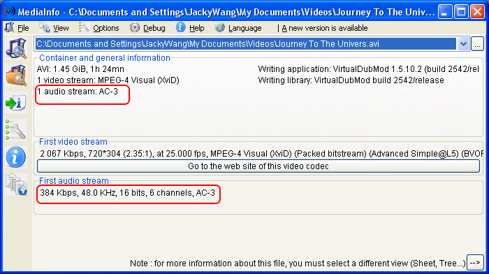

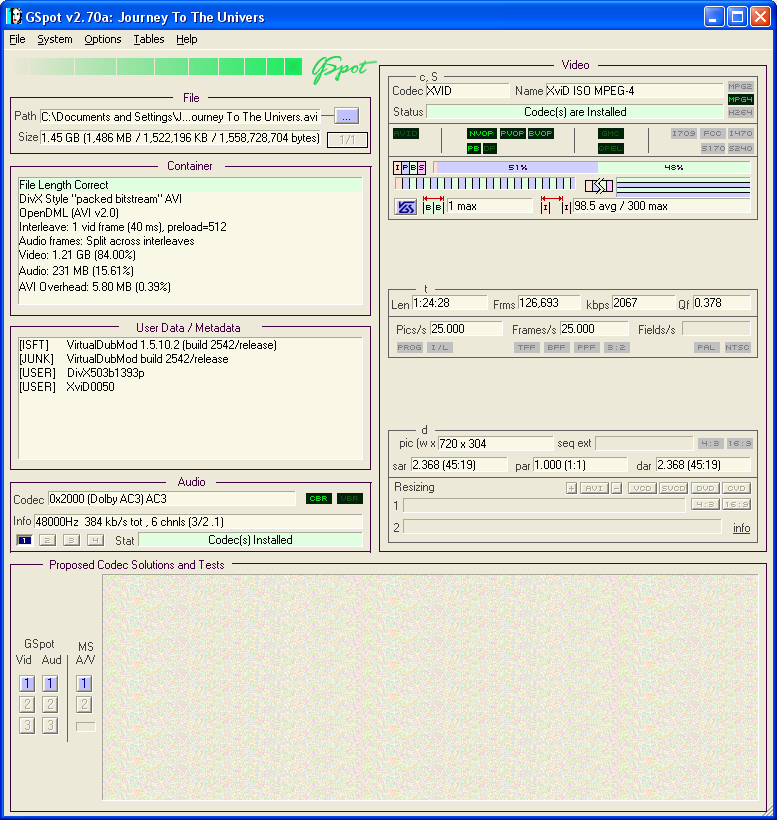

    Hello! Can someone please help me to figure it out what exact problem.
    I'm using TAW4 and now I'm having a problem with and AVI files contain AC3 audio. My input file was AC3 (5.1 Ch) audio but when I load it into TAW4 I only got 2 ch audio (please see the pics).
    I'm sure it has something to do with Audio Codec but I can't figure it out how to fix it. I'm really need your help on this problem. Please help me.
    Thanks.
    PS: I tested a lot of files with an AC3 audio (MP4, AVI) but I got the same result.
ID:	7449Click image for larger version
