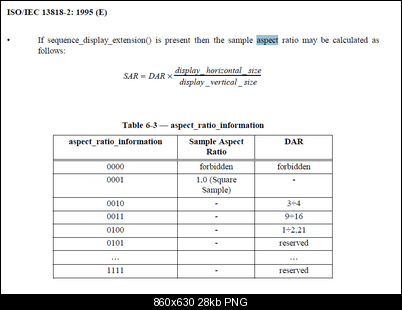

  1. There's no such thing as a 1.304 DAR in MPEG encoding. If he imports the MPG files directly from Mpeg-VCR they should have the correct DAR flagged.
    The MPEG 2 spec only has three defined display aspect ratios: 4:3, 16:9, 2.21:1 and square pixel PAR.
    Well OK, it's possible to have a 3.04 DAR with square pixel encoding and the appropriate frame size. I don't see how AVStoDVD can be getting the DAR wrong with a 352x480 frame size. Unless MPEG-VCR is adding a sequence_display_extension with the wrong values.
    The OP should upload a small sample of his MPEG-VCR files.
