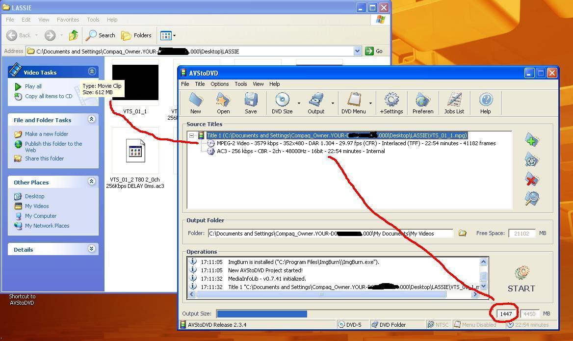

    I'm still having the same problem a year and a half later. Hoping someone can help.
    I tried to author a DVD last night using AVStoDVD. I added a title. It is 612MB, but the output size increased to 1447MB!
    I have had similar problems when trying to make a copy of a DVD using DVDShrink and the size was doubled, too, so I don't think it is just AVStoDVD.
    I'm wondering if there is something wrong internally with my computer. I have a dvd burner.
    I'm enclosing a screenshot to help explain my problem:
    [Attachment 15287 - Click to enlarge]
  7. Originally Posted by Ronny G View Post
    That's not unusual. MPEG 2 encoding (required for DVD) is not as efficient as some other codecs so it requires higher bitrates, hence larger files. If you started with an Xvid AVI or h.264 MKV, for example, you would expect the file size to grow like that.

    I just don't know why the output size is 1447MB.
    It is a 22minute TV show.
    I have been able to fit 5 of these 22min shows on a single-layer DVD in the past with no problem.

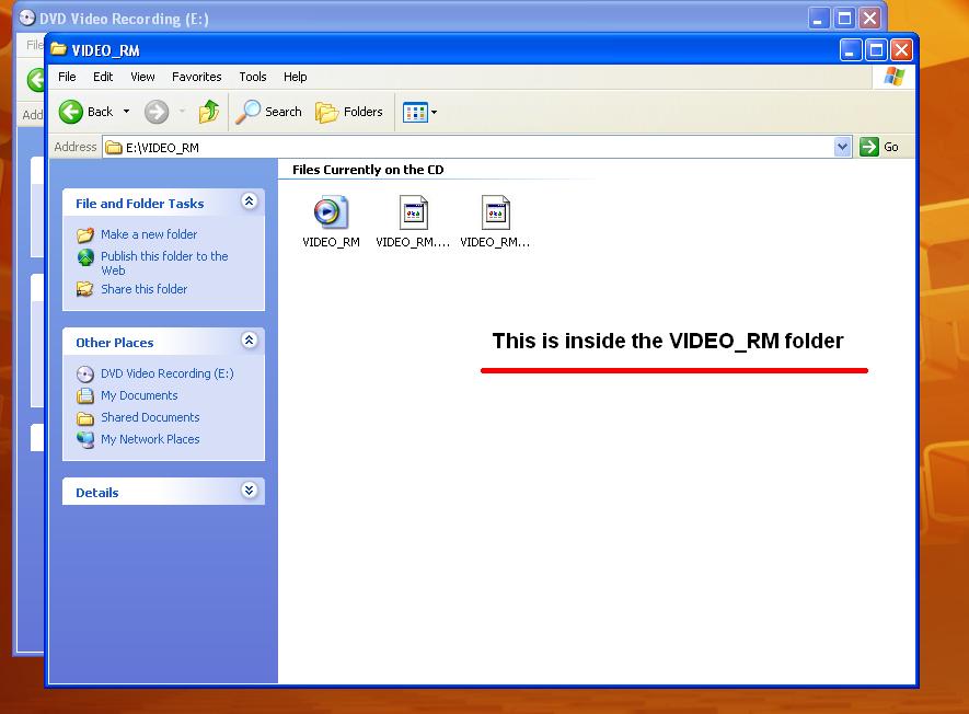

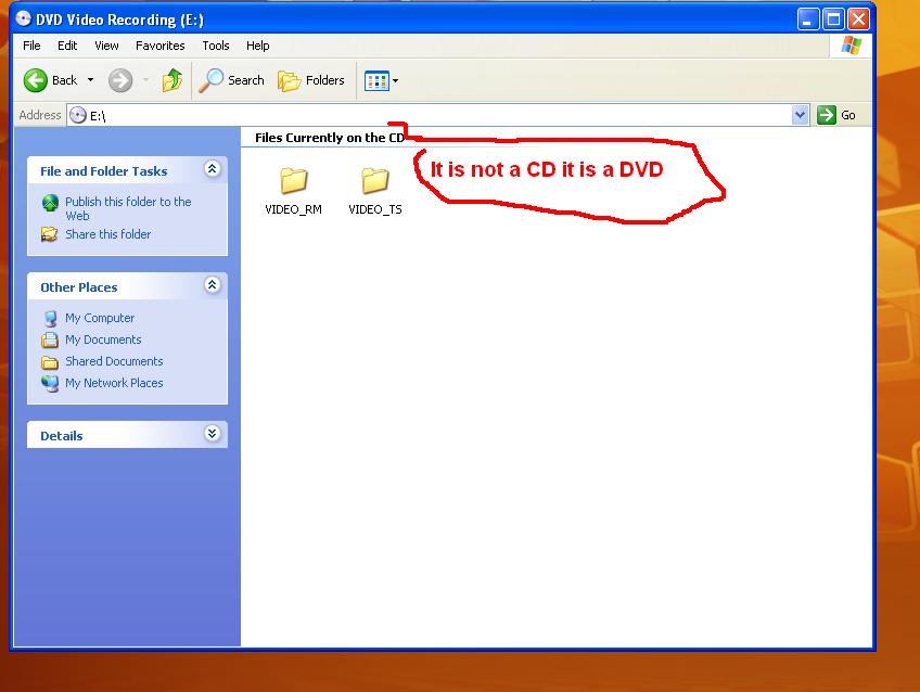

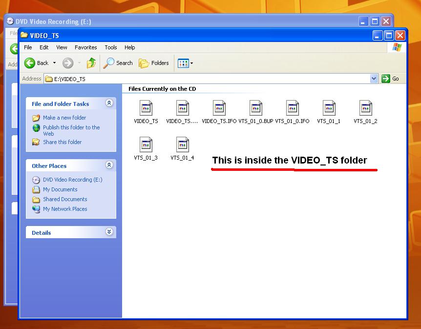

    Alright, I'll go back to the beginning:
    Here is the original source.
    I recorded 5 30-minute episodes on my magnavox DVR player in SSP mode on a single-layer disc.
    I put the disc in my computer. I right-click 'open' on the disc icon to explore the contents.
    It has 2 folders: a VIDEO_RM and a VIDEO_TS folder.
    [Attachment 15295 - Click to enlarge]
    [Attachment 15296 - Click to enlarge]
    [Attachment 15297 - Click to enlarge]
    DVD Shrink will not open the disc. It says invalid DVD structure.
    DVD Fab will open the disc, but it shows 11 titles(???) when there are only 5 titles!
    Anyway, I made a copy of episode 1 a video folder not an iso.

    Do you mean this one: As you can see I added a title. It is 612MB, but the output size increased to 1447MB!--nearly a third of the dvd. At this rate I can only add 3 titles to fit on a single-layer dvd without losing quality.
    [Attachment 15303 - Click to enlarge]
    All your attachments are invalid links. I have no idea what you're doing.
    Your input MPEG is being re-encoded. Without a short sample of your original vob input (or a text copy of a MediaInfo readout), no one can be certain what's happening.

    According to the image, you're inputting an MPEG2 recorded at a variable bitrate (most likely) and re-encoding at a constant bitrate (CBR). That might explain part of it, anyway. Most DVR's record at variable bitrates (VBR) for smaller file size.

    Here's what the screen looks like when I add 3 titles. It fills up a DVD-5 disc. In the past, I've been able to fit 5 titles on a disc without compressing them.
    The program always tries to fill the disc. Add 5 titles and you'll see you get a full disc. Add 7 titles and you'll still get a full disc. The program changes the bitrate to accommodate the total running time (ie, each episode will be smaller as you increase the number of episodes).
    The reason a single 22 minute episode doesn't fill the disc is because there is a limit to how high a bitrate you can use on DVD. 22 minutes at that max bitrate comes out to 1447 MB.
    And once again, since your sources are already DVD compatible you will be losing quality by reencoding. Use DVD authoring software that doesn't reencode.

    The input files are 352*480, 1/2 D1. Is it possible your project settings are set to 720*480, or
    some other factor causing the program to re-encode the files?
    If it's passing the files as-is to the authoring stage it would only take about 10 minutes.
    Likely a few hours if re-encoding, depending on the CPU.

    I just noticed 352x480 as well. The recommended 4500/6500 max VBR bitrate for 2 hours of video could be raised to 5500/7000 for half-D1. It's a smaller frame size, but a few extra databits per frame will make it look better on a big TV. 352x480 has to be upsized more than 720x480 to fill a TV screen. Think of it as the difference between making an 8x10 print from a large negative, compared with making the same enlargement from a smaller neg. There's little sense going above 7000 max for that frame size, as you wouldn't see any more detail and would waste disc space.

    The source mpeg2 file is not 100% DVD compliant because the DAR (Display Aspect Ratio) is reported as 1.304 and not 4:3 or 16:9. Thus AVStoDVD (that is a bit choosy) is re-encoding it.
    But, if you want to force AVStoDVD to ignore the DAR flag, there is a workaround.
    1. Download latest AVStoDVD release (2.5.1 vs 2.3.4 you are using)
    2. Add your title
    3. Right-click on the title and select 'Edit Source Title Info'/'Video Display Aspect Ratio'
    4. Insert 1.333 vs 1.304
    5. Verify in 'Edit Title'/'Video' that 'Video Direct Stream Copy' is on
    Repeat this procedure for all the titles grabbed with the DVR.
    Let me know
