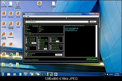

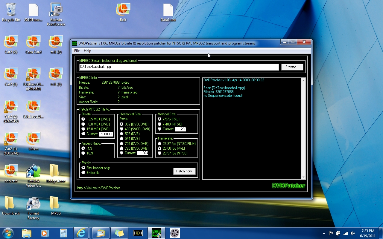

    I don't think it's only the file size, but the sequence header seems to missing

    The menu shows
    3.5 Mbit DVD
    352x576
    25 fps PAL
    Half res SD.
    What are you trying to do?

    I'm sorry. I will try and do better with my screen captures.
    That is what the DVDPatcher defaults to when it won't read a file. I'm assuming because it does not have a sequence header.
    I used Sothink's Free Media Converter to convert the 26GB file to MPEG-2. It compressed to 12.7GB and the DVDPatcher program worked for the aspect ratio change. It took a little over an hour for Sothink to encode the file. I'm going to see how it looks.

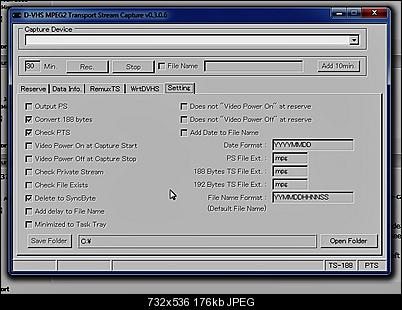

Name:	ScreenShot003 (732x536).jpg
    I can change the aspect ratio of the video, but sometimes I have to run it through software to put in sequence headers. That is what consumes the most time. About an hour or so for the big files. Then DVDPatcher to change the A/R. Other than that, I can change the format on my TV and restretch it.

    No need to confuse the guy. As edDV pointed out, CapDVHS saves transport streams (with a 188-byte header: TS-188 on the screenshot) but lets you use any file extension.
    ckp, you don't need to go through all this mess if you're only going to be viewing the file on your PC. With a decent player you can override the AR to 16:9.

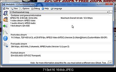

    I can send you a small file, 55 MB that is unedited. On all my Windows 7 pc's, it has a .mpg extension. Maybe I'm missing something. PM me your email if you want.
  25. MediaInfo and GSpot both report the container type, even with renamed files.

Name:	ScreenShot004 (715x416).jpg
    MediaInfo unedited file. DVDPatcher will not read this file
  27. MPEG-TS is a transport stream. The the file extension should but .TS. MPEG program streams should end in .MPG.
