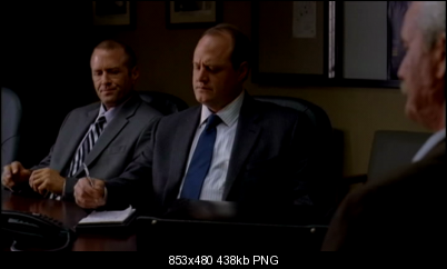

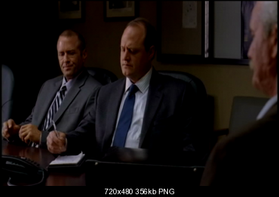

    So if I get this right, you are going S-Video from sat tuner to the DVHS JVC 40000U and Firewire to the PC and recording with CapDVHS.
    S-Video is always SD and will normally be converted to 704x480 with 4:3 aspect flag. There is no "wide" flag for analog S-Video but it may be possible to configure your sat box to output in "wide" mode via S-Video. That would result in a horizontally compressed image when viewed as analog S-Video.
    This is what wide 704x480 looks like horizontally squeezed. This was caped 720x480 off S-Video
    so shows 8 pixels blanking left and right.
    The 4000U will still assume this is 4:3 for Firewire pass through unless it has a menu setting to ID the analog input as wide.
    The format the 4000U outputs is MPeg2-TS at 704x480 for SD. CapDVHS seems to lack any menu to over-ride the aspect ratio flag coming in. It just recordes the MPeg2-TS stream to a TS file. CapDVHS allows you to choose a file extension (e.g. TS, mpg, M2T, etc.) but this in no way changes the video coding, only the file extension.
    So, assuming the horizontally compressed image makes it to the TS file, you can now use a third party app to change the aspect ratio flag in the video header. There is no need to recode.

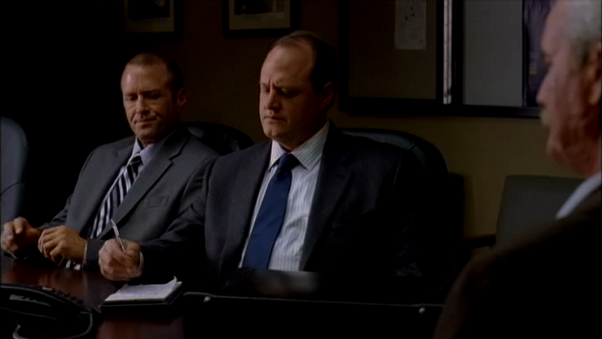

  24. Member edDV's Avatar
    Mar 2004
    Northern California, USA
    This how the picture above displays when scaled to 16x9 (i.e flag changed to wide).
