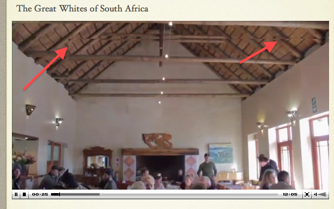

    I have noticed that when I play it, in scenes of movement such as camera pans, the picture "slices" up and looks choppy. I took a screen grab to try and illustrate what I mean...
    But if I let the video play a while, then drag the playhead back to the start, it plays smoother - although there does remain some stuttering.

  10. Explorer Case's Avatar
    Feb 2004
    Middle Earth
    The video itself is 640x360, but is displayed at 640x340. The 20 pixels vertical difference is filled with the controlbar. The resulting squeeze may be the source for the video artifacts. So, for a 640x360 movie, you should reserve a player area of 640x380!
    Jun 2011
    South Africa
    Thanks for that! I changed it by 20 pixels but the choppiness is still there although now and then, so I think it's to do with my Internet connection.
