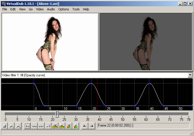

    Use Virtualdub with the Fill filter in Blend mode. Under View, choose Curve Editor and adjust the curve to get the fade that you desire. Under compression, choose the original codec and choose Smart Render to keep from re-encoding the whole file (with a seven second file it's not a big issue but on a large clip it would be).
    http://smg.photobucket.com/albums/v473/DarrellS/?action=view&current=Fade02a.mp4

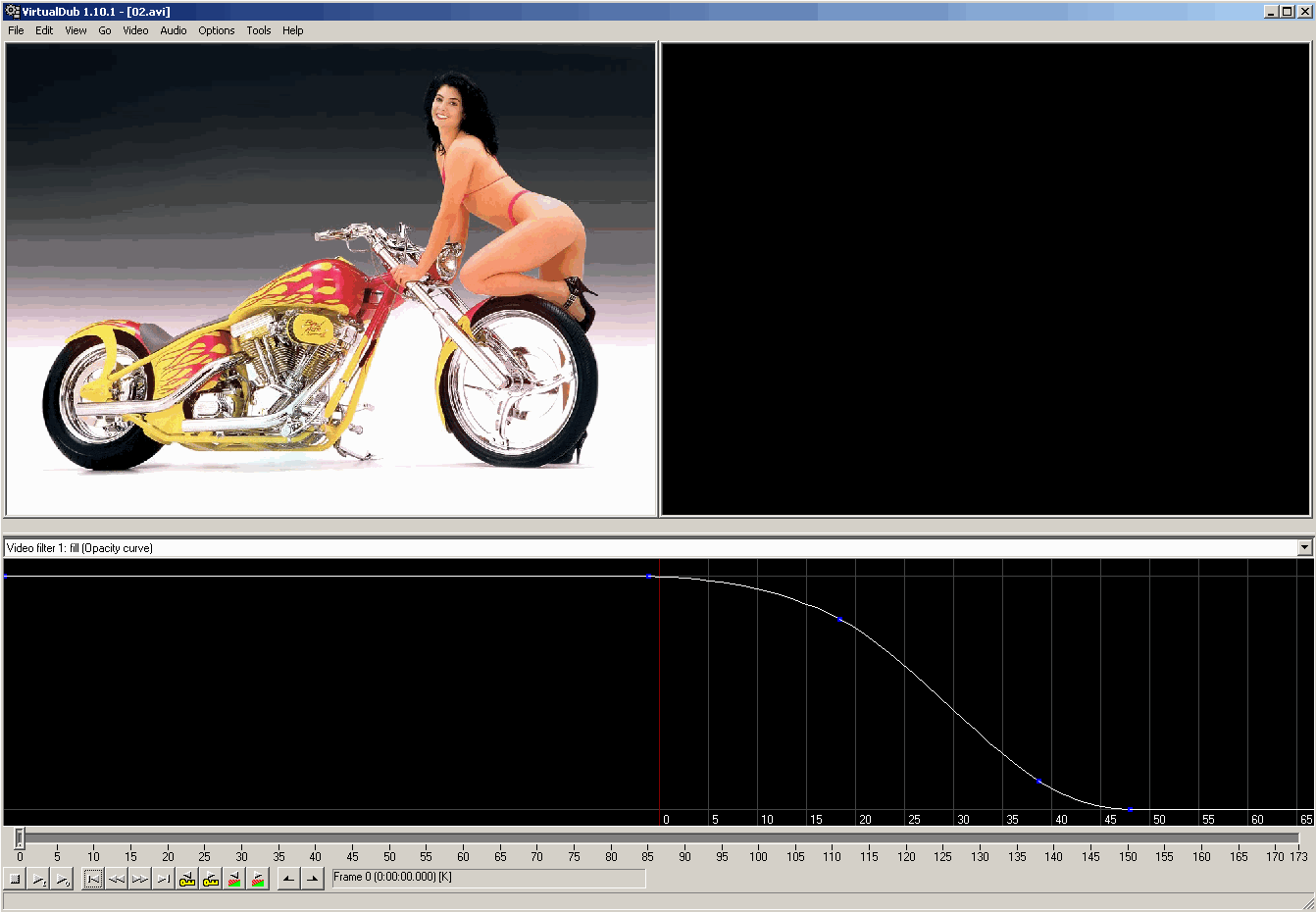

    No. That is what the curve is for. You create points at the bottom and raise them to create your curve. You can make as many fade ins and fade outs as you want with the curve and only the points where you have created your fades will be re-encoded if you use Smart Render.
