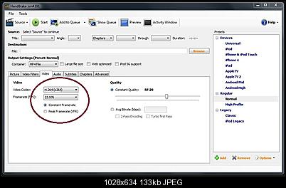

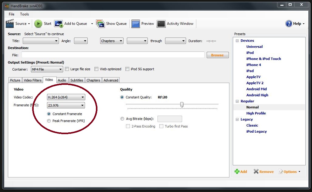

    If you want to completely change the frame rate of audio+video and you don't want complicated options, try Handbrake for windows. See the video tab there? Select Constant Framerate and use the drop down box to select whatever framerate you want. Then tweak the video settings to what you want.

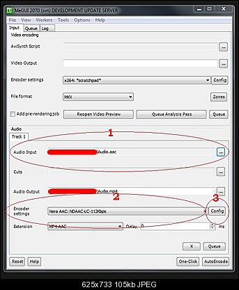

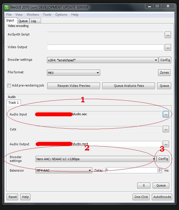

    If you are like the OP and want to change the sample rate of the audio stream only, I was suggesting that you can use MeGUI.
    1. Select the audio file
    2. Select the audio codec (MPA, MP3 etc)
    3. Click the config button.

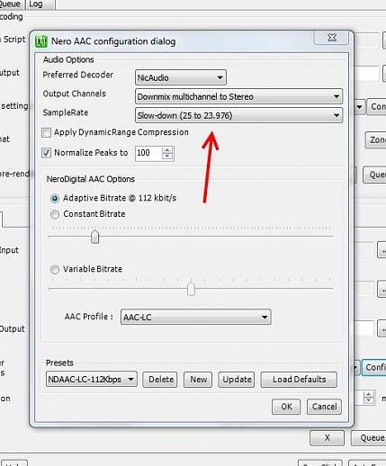

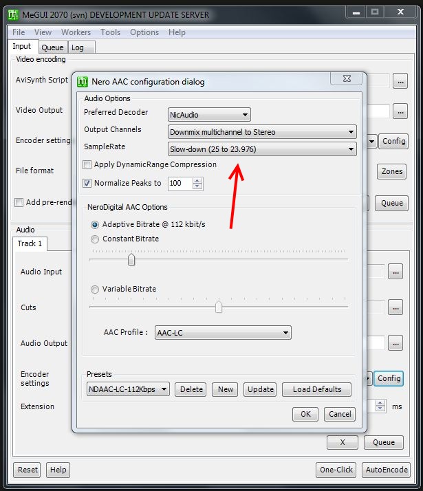

    Then the config Screen comes up:
    Use the preset to change the audio sample rate.

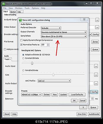

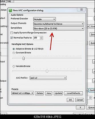

  14. if you change audio in this way:
    and if this is audio from movie, the actors in movie will start speaking slowly .......
    Slow-down (25-23.976) - means changing the speed of talking
