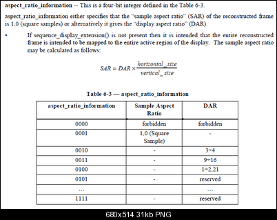

  13. I usually just assume the full 720x480 or 720x576 frame is the 4:3 or 16:9 display aspect ratio. That corresponds to 32:27 and 64:45 PAR.

    Yes. I decided on that because that's what the MPEG 2 spec says. Even though some movies appear to use the 704 sub frame.
    As you can see there is a mechanism to override that calculation, by using the sequence display extension. But I've never seen that used except to define a 4:3 pan/scan area on a 16:9 disc.
