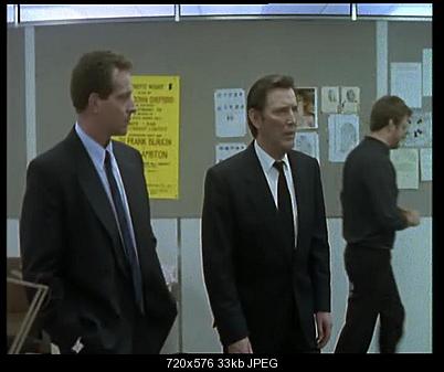

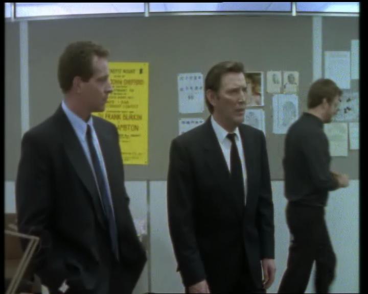

  25. Mpeg2Source("VideoFile_test.demuxed.d2v", CPU=6)
    BlindDehalo3(last, rx=3, ry=1, strength=200)
    before:
    after:
    Note the transitions from the white wall to the black suits and back to the white wall. In the before image you can see strong halos. In the after image they are mostly gone. Yeah, it's pretty slow.
