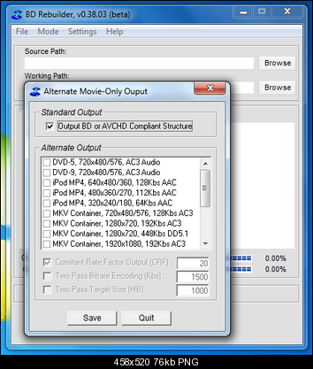

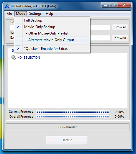

  3. use bdrb. Select movie-only backup then alternate movie-only output. Select either dvd-5 (single layer) or dvd-9 (dual layer). Then click backup. Resulting folder will be dvd format.
ID:	7325Click image for larger version

    I haven't tried the DVD-5 or DVD-9 options in BDRebuilder but I thought that all they did was just more compression, not conversion to DVD format. I'd suggest testing that to be sure it works as mrswla says.

    Well Baldrick's guide at
    https://forum.videohelp.com/threads/335372-How-to-convert-Blu-ray-to-standard-DVD-Video...ing-free-tools
    suggests that you will get a dvd5 or dvd9 from this.
