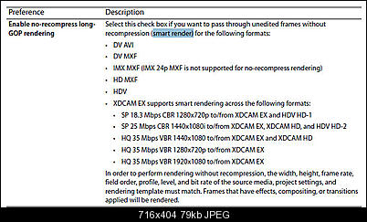

    Vegas does Smart Rendering. See the specs:
    Note that .MXF is a Sony optimized container with Mpeg2 inside. You don't HAVE to use this though. It's purpose is roughly equivalent to Apples AIC, in that it's Sony's version of an intermediary format.
    You need a high power computer to edit H.264 in real time, and if you don't have that, you can convert to .MXF. You're gonna have to convert anyway.

    MXF is not necessarily MPEG-2.
    What software is used to watch the videos?
    Does it still have the MXF extension, or is it now using something else?

    MXF is the "Material Exchange Format" intended for cross platform exchange in a pro environment.
    http://en.wikipedia.org/wiki/Material_Exchange_Format
    It can contain many formats including MPeg2 (XDCAM), DV, DVDCPro (P2 cards), AVC-Intra, etc.

    Hey, you guys got me on that .MXF faux paw. I never dug into the custom settings, just chose the Sony .MXF and figured that was a hint. When they add "Sony..." to something, that usually means they tweaked it for you. You know, "Sony Style", hehehe.
    Since the topic was about Smart Rendering, I don't know if those other formats can Smart Render, can they?
    Funny how FCP seems to be the only NLE that DOESN'T support .MXF, and it's a pro container, and FCP is supposed to be pro, right?
    As one can imagine, Sony Vegas is highly tuned to support Sony consumer and pro camcorder formats. Smart rendering is supported for DV, IMX, HDV, XDCAM, XDCAM-HD, XDCAM-EX (MXF) and HDCAM.
    I find if you make HD MPeg2 look close to XDCAM-EX MPeg2, you can get HD MPeg2 TS captures to smart render too.
    The odd man out is arch rival Panasonic. You need to use plug-in (see Raylight) software to support DVCProHD P2 MXF. Not sure about AVC Intra. JVC used to be difficult but recent Pro JVC MPeg2 camcorders output formats very similar to XDCAM-EX.
    Missing currently for smart render are consumer AVCHD and Sony's pro NXCAM variation. You can bet those will be supported in future versions. That would open the floodgate to all the Canon AVCHD cams.
    Currently AVCHD must be fully re-encoded in Sony Vegas and most other edit software. Exception may be GV/Canopus Edius.
