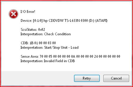

  10. Hi hech54,
    I have installed imgburn and after running it I inserted the DVD..
    attached are some screenshots and one log file.

  11. Hi hech54,
    Can you confirm with the attached screen shots and logs that the drive is faulty so that I can replace it.
