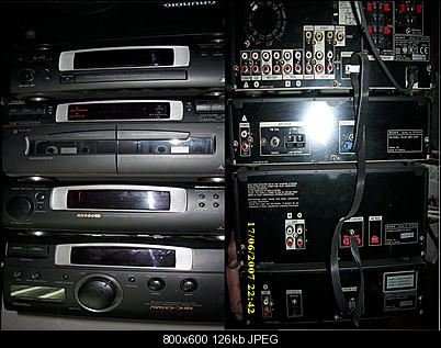

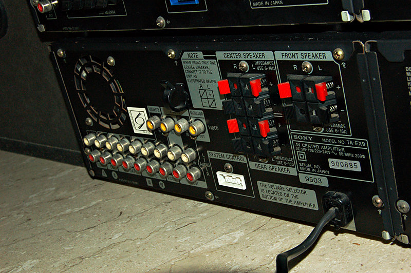

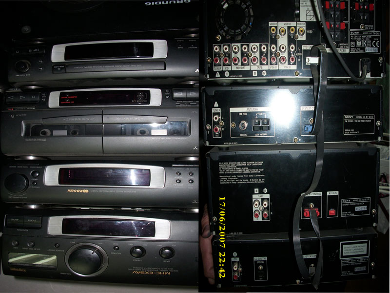

  1. I own an old Sony Hi-Fi that supports Dolby Pro Logic. I read that this was one step before Dolby Digital (AC3). But i still cant understand if this is really for surround sound environments, or if it is just a slight upgrade from stereophonic sound.
    What's the best use i can get out of my Stereo that supports this format?
    As far as i can see, it supports up to 6 speaks.2x Front/Rear/Center. I've got 7, i've also got the TOP one, and i'm also wondering how to connect the extra speaker...

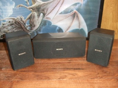

  5. I Still dont get some things though. Mostly how is it supposed to get information from 4 different channels via a simple red/white cable?
    So the Center speakers are placed right above and underneath the TV?
    Here's what i got.
    So the middle one must for center, but i only got one, So if i place it on top, i aint got nothing for bottom so the sound, will be like its coming from above the TV as you said. How do i solve this?
    As for left and right i got 4 of what you see, on the picture. Although 2 of them are rated 8 Ohm/70Watt "SS-SR12" (see pic below) and the other two are rated 16 Ohm/20 Watt "SS-SR151". Which ones should i use as surround (rear) and which as front?
    And finally i got 2 large groundspeakers, that at first i thought they were to be the center speakers, but now i understand that small top/bottom are supposed to be center...
    So i'm still non-conclusive on the matter.

  7. Originally Posted by therock003 View Post
    When the two channels are in phase the sound is routed to the center channel. When they 180 degrees out of phase the sound is routed to the rear.
    Here's what i got.
    [Attachment 7309 - Click to enlarge]
    If you only have one center channel speaker you have to put it above or below the TV screen (in movie theaters it is located behind the projection screen).
    Use the 70 watt speakers in the front, the 20 watt speakers in the rear.
    Two sub woofers? Placement of those isn't critical. It's difficult to tell what direction very low frequencies are coming from. Do they have inputs and outputs? If so, go from the receiver to the subs' inputs, then from the subs' outputs to the left and right speaker.
    The HiFi allows for 2 of them but the packaging only had one. What if i place it behind the screen as well, facing the wall, so the sound gets refracted to the wall. Would that be wise, ot just hit and miss?
    I thought that the rear ones needed the extra power, since the signal has totravel the greater distance from the HiFi source. How come the front get the 70 Watt Power?

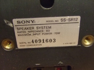

    I'm not sure if they're meant as subs. I'll post some picture of them as well, so you can take a look for yourself. Maybe i'm describing them wrong.

    Would you rather suggest i dont use the one that is solo, and use a pair of the small ones instead to have it properly up and down the TV set?
    As for the ones i mentioned as ground speakers, i cannot get a picture online, but i found this manual. IT seems they are front/center and super woofer all in-one. They even have external connection for rear speakers. Could this may be prefereable?
    I did find the manual though.

    You need to figure out exactly what each of those speakers is. It sounds like you have more speakers than originally came with the system. Do the big floor standing speakers have grills that you can remove? Or can you see the drivers through the grill? Do you see multiple drivers? If so, those should probably be used for the front left and right speakers. You can choose to use the center in addition, or not.
