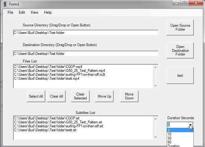

Okay since no one has updated for what you want yet, I came up with a quick and dirty (well just no bells and whistles) Windows Program. I tested it on Windows 7 and it works unless you select the entire duration and it is longer than 1 hr.. I have to fix that yet but the drop down 5, 10,30,60 seconds works.
[Attachment 49990 - Click to enlarge]

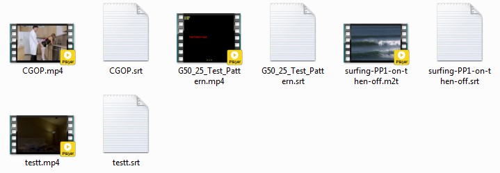

Creates srt files in folder with video files with just names of video.
[Attachment 49991 - Click to enlarge]

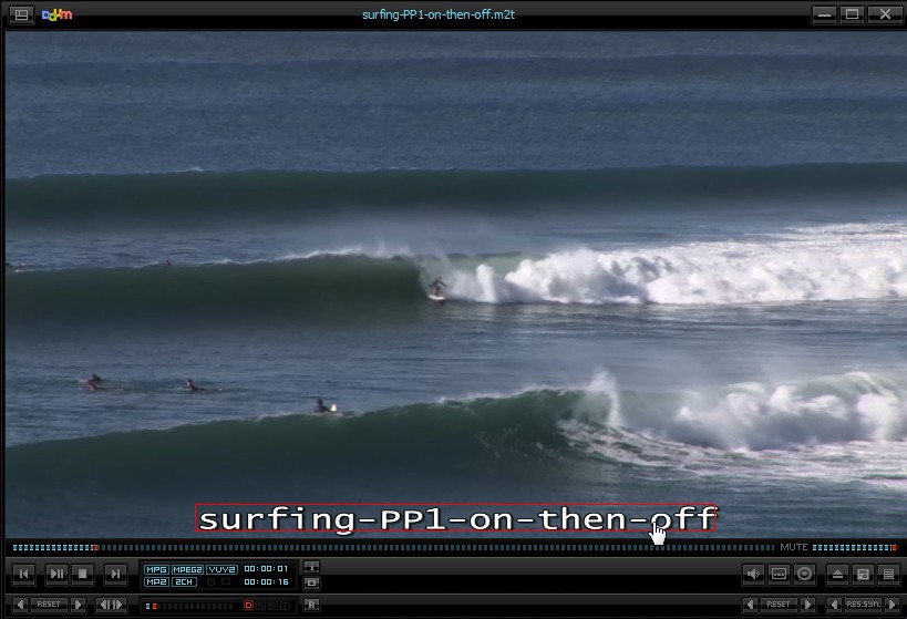

Subtitles look like the image below
[Attachment 49993 - Click to enlarge]
Haven't finished debugging but does it look like it will fit your needs? Hope I understood what you wanted. Pay no attention to the red outline on the player. PotPlayer just allows you to select the subtitle when the player is paused.Last edited by Budman1; 1st Sep 2019 at 04:05.
Thank you very very much. Exactly that's what I need. Thank you for your time and work and for "getting dirty" for my program. I donīt need it for more than a couple of minutes so donīt worry, i wonīt select the entire duration. Again, thaaaank youuu for your time, knowledge and good vibes!!!
