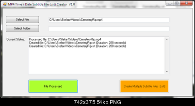

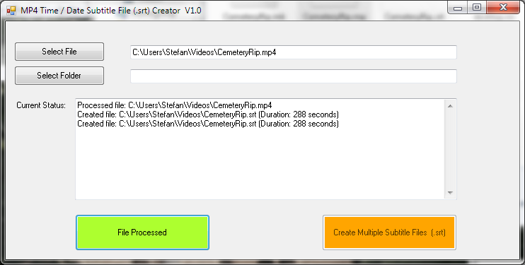

    It seems to work fine. Tried it on a random mp4,

  3. Would you able to make your program also works for M2TS file? It would be very helpful for all my home videos.
    Thanks,
    Jess
    May 2011
    Scotland
    Jess,
    If you can send me 2 M2TS files taken with your camcorder (short videos, just a couple of seconds) I will analyse the structure and see if I can modify my program to output the .srt subtitle file.
    Stuart

  14. I'm a MEGA Super Moderator Baldrick's Avatar
    I added a mirror
    TimeDateSRTCreator
    ( I will make a bigger screenshot later).
