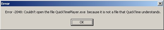

  1. My Canon Ixus 220HS produces MOV files. When I use R-click > Open With > Quicktime Player (Version 7.6.8 1675) I get very odd behaviour.
    First, it gives this error:

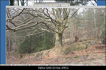

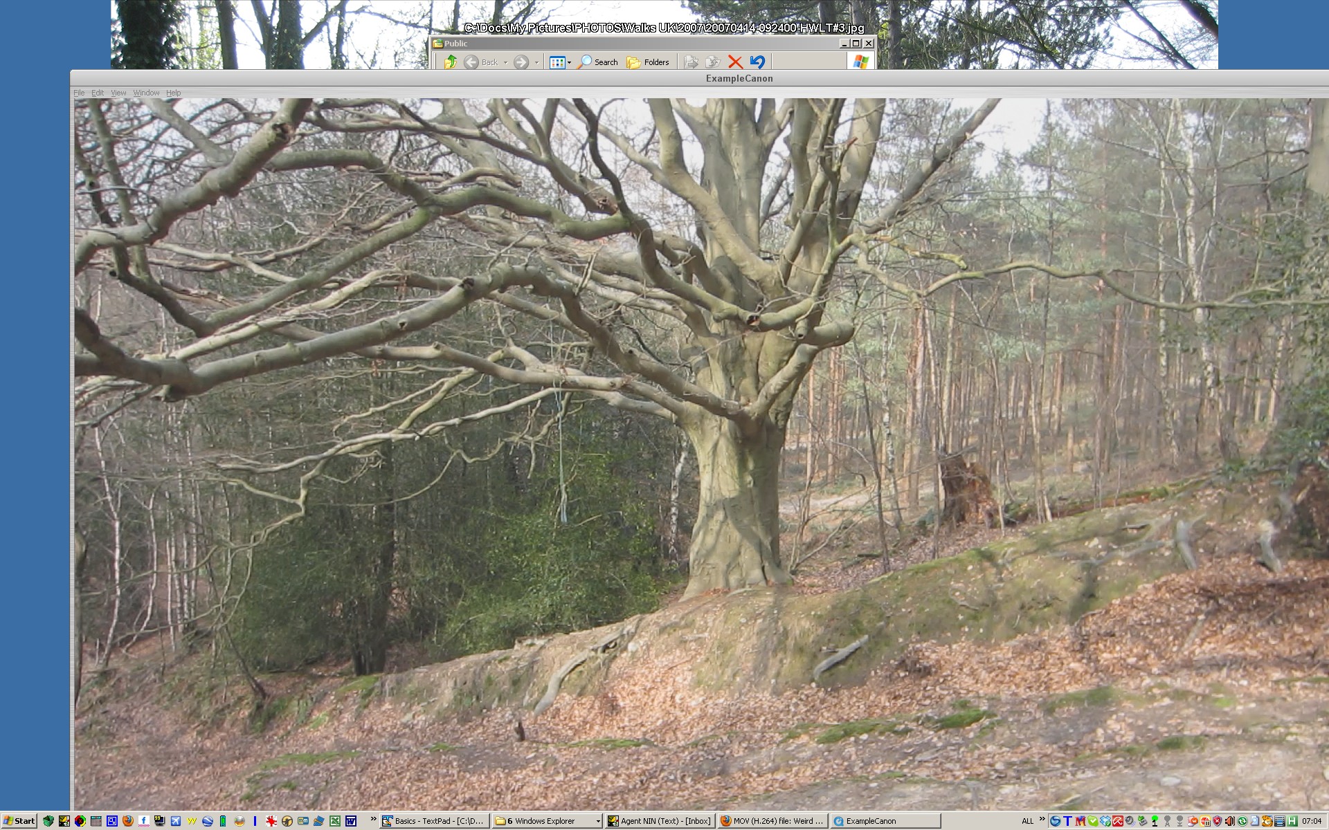

  5. Here is an example (taken by accident, which is why it's only 5 MB).
    http://dl.dropbox.com/u/4019461/ExampleCanon.MOV
    Here's what my desktop looks like immediately after opening it with QT 7.6.8 (1675).

  6. No one able to try this yet please?
    Terry, UK
  7. Downloaded the file. No problems playing it here with MPCHC or VLC. Quicktime Players is one of the worst players under Windows. And Quicktime in general is messed up under Windows. Use another player.
  8. Agreed, QT is one of the worst players for many reasons, and not just on Windows
    But it works for me QT Pro 7.6.5
  9. Explorer Case's Avatar
    Feb 2004
    Middle Earth
    The clip played just fine at 1920x1080 on Mac OS X 10.5, but I suppose that doesn't mean much for your setup.
  10. Thanks guys. Still hope to hear from someone who tried it with QT on a PC, to see if that oversized initial window is unique to me or not.
    Terry, East Grinstead, UK
  11. My test was on windows QT Pro 7.6.5. Make sure the view options are set to normal size (ctrl+1)
  12. Originally Posted by poisondeathray View Post
    So you don't get that 2048 error then?
    I can set View to Normal only after it opens oversized. And then it still opens oversized the next time.
  13. Correct, no errors, opens and plays as expected . I think your install is corrupted, or that version is buggy
