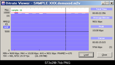

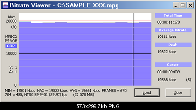

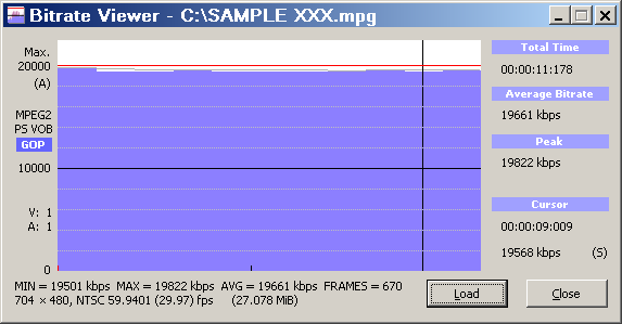

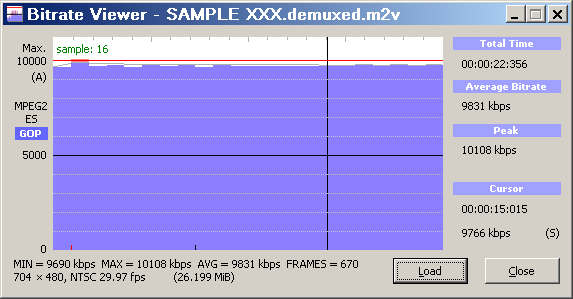

  10. Originally Posted by sanlyn View Post
    Your MPEG has a max bitrate of 12180 kb/s.
    Weird, Bitrate Viewer shows it's about 20,000 kbps CBR:
    MediaInfo says 9800. GSpot says 9830 avg. A quick calculation based on file size gives about 9800 (27,000 kbytes * 8 / 22 sec). I usually find Bitrate Viewer to be most accurate but something about this file has it confused. For some reason it thinks the frame rate is 59.94 fps, and hence shows the running time is only 11 seconds.
  11. dgindex preview also suggests ~9.8 Mb/s
    wonder why bitrate viewer is so off ? If you demux to elementary stream , it gives correct value
  12. I tried a remux with Mpg2Cut2 and Bitrate Viewer showed the same thing. But demuxing with DgIndex gives an M2V file where it shows the correct values:
    That's in Bitrate Viewer's "1 second" mode.
