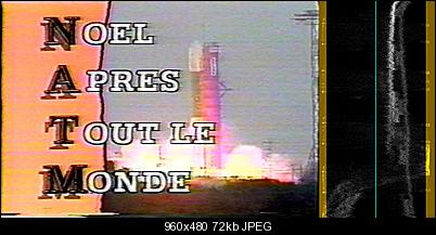

  2. In that last video the darks are too dark and the brights too bright:
    You should use Histogram() or VideoScope() to check your levels.

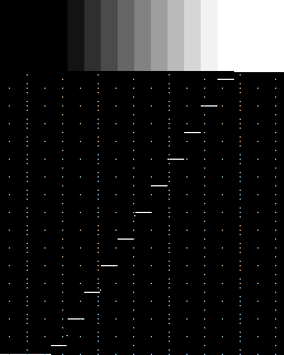

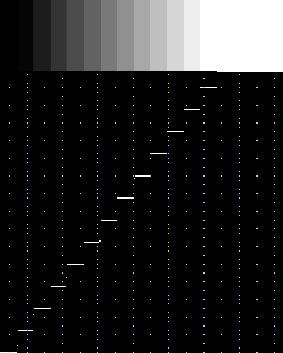

    off_y moves the whole graph up
    gain_y stretches the graph from the bottom
    cont_y stretches the graph from the middle
    gamma_y is a non-linear stretch from the bottom (brings out shadow detail)
Size:  1.1 KB off_y=64 --> Name:  offy.png

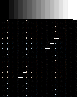

Size:  1.1 KB gain_y=64 --> Name:  gainy.png

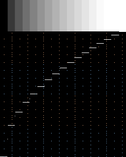

Size:  1.1 KB cont_y=128 --> Name:  conty.png
Size:  1.1 KB gamma_y=256 --> Name:  gammay.png
    Negative values move the graph down or compress the range.
