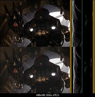

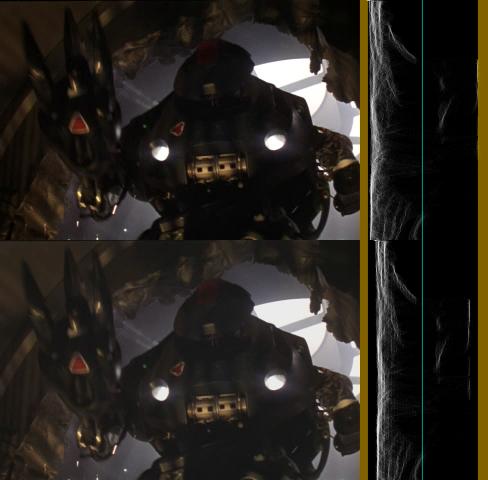

    You mean ColorYUV(Levels="PC->TV")? That's probably not right. Check the levels with Histogram(). Make sure the video stays predominantly out of the brown bands. But you want your blacks to be at the left band, brights at the right band:
    Obviously, not every shot will have full blacks and full brights. Adjust for a variety of shots.

    i did the histogram() and everything looked fine ,
    it was a fitcd setting .
    isn't the same has ConvertToRGB(matrix="PC.601") but for ColorYUV ?

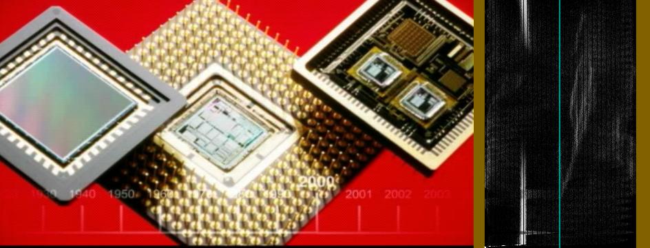

  13. Since you are specifying upConv=1 in Mpeg2Source() the output of Mpeg2Source() is YUY2. So the ConvertToYUY2() at the end of your script is redundant.
    The levels should already be in the Y=16-235 range. (Maybe the AIW is unusual in this respect?) ColorYUV(Levels="PC->TV") will then compress the Y range even further, roughly 32-215. If the levels were right to start with that will give very washed out, dull looking video. On the top is the normal MPEG 2 video, below after ColorYUV(Levels="PC->TV"):

    info() gives me assume bottom field when i know it should be top field
    gives me yuy2 , not RGB like mediainfo says
    and the histogram() gives me a little too much blacks
    sample made with virtualdub in direct stream copy
    and my audio isn't in sync anymore ,, plugged directly in the soundcard

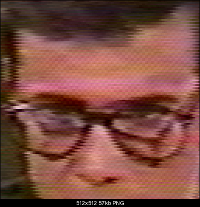

  23. Ouch! The saturation is way over the top. I'd start by pulling those down:
    ColorYUV(cont_y=-10, cont_u=-80, cont_v=-80)

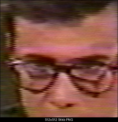

    would look like this
    now my problem is sync the audio went direct to the soundcard and the video was buffered into the tbc giving me out of sync , (hope it's not gradual lost of sync)
    i'll try to test this with media player classic . never done this before
    i'll check the sync at the start and the end of my capture and hope i get the same results

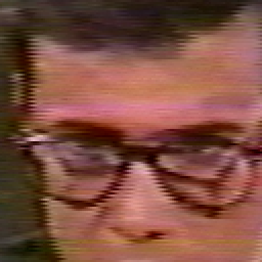

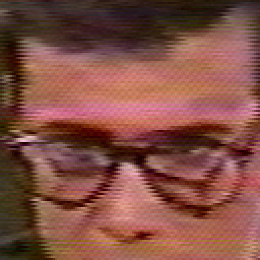

  27. You can use CheckMate() to reduce the dot crawl. Unfortunately, it only works in YV12:
    AviSource("Sample (12 40 am).avi")
    AssumeTFF()
    ConvertToYV12(interlaced=true)
    CheckMate()
    Before Checkmate() (4x point resize):
    After Checkmate() (4x point resize):

    using this
    LoadPlugin("C:\Program Files\MeGUI_2008_x86\tools\avisynth_plugin\checkma te.dll")
    LoadPlugin("C:\Program Files\MeGUI_2008_x86\tools\ffms\ffms2.dll")
    FFVideoSource("F:\100 limites\Sample (12 40 am).avi").AssumeFPS(30.116)
    AssumeTFF()
    Checkmate()
    is my ColorYUV(Levels="PC->TV") obsolete ?
    i checked with histogram() and helped my blacks
  29. Yes, ColorYUV(Levels="PC->TV")is crushing the range too much. My ColorYUV(cont_y=-10...) might not be quite enough. Try maybe -15 instead of -10. You have to look at a wider variety of shots to be sure though.
    Then you can start thinking about general noise reduction. Try something like MCTemporalDenoise()
