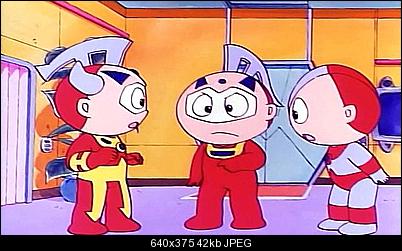

    Hello,
    I have improved my video file a little using AviSynth filters with some VirtualDub filter too.
    It gave me a good result but the only think i can improve it of make it look better is the
    color of the video. i don't know any avisynth filter can help out but i used some VirtualDub
    filter like HSV adjust & RGB Equalizer but the result still not good..?!
    What should i do improve the color...?!
    screenshot:

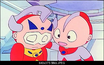

    Note:
    If necessary I can upload an original video or after the filtering ...
  2. what do you see as the problem?
    I think the reds are oversaturated - there is line detail missing because of this (e.g. you cannot see the outlines of the hand in the 2nd picture)

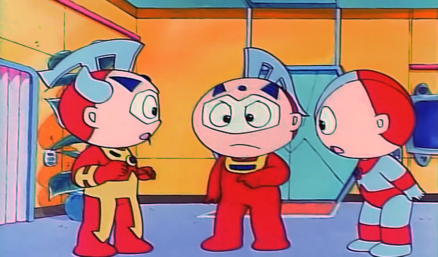

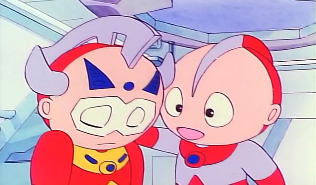

  5. Without knowing what the images should look like it's hard to say what they need. Yes, the reds look to be over saturated. Blues need to be increased.
    Maybe something like this:
    ImageSource("kidsv.jpg")
    ConvertToYUY2()
    ColorYUV(off_u=14, off_v=2)
    ColorYUV(cont_y=60, cont_v=-40)
    I shot for making the eyes white, toning down the V channel, and adjusting the levels. You'd have to look at more shots to see if that's about right.

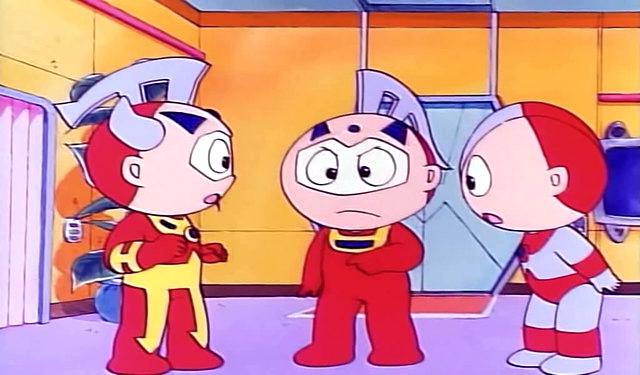

  6. I'm not saying this is correct, but if you bring the red saturation (or global saturation) way down, you can see how much "is left on the table". I think there should be dark lines around the middle "guy"'s hand
    Also, it's unclear how these screenshots were taken, or if any processing has already been done, they are already clipped on both ends, especially red channel on the high end, blue on the low end. Perhaps something more is salvagable with original YUV source ?
    Some curves, 3way color correction - Again, not saying this is correct, but just to illustrate that there is detail missing because the red channel is blown , and red is oversaturated causing obscuring of details. The "original" looks like a red blob, but you can see the middle "guy's" hand outline here. You should be able to do this with gradation curves and color mill in vdub. This example below is still "illegal" by the vectorscope, and should actually be desaturated a bit more
