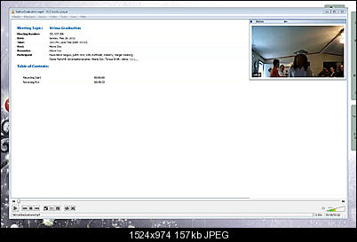

  8. I haven't tried joining yet. I'm trying to keep my cost down for this client to get this thing uploaded to her site. I had her try to download another version of the file from the company. She got an mp4 which was complete.... but the video is a tiny box on the upper right with all the info about it on the left! Unreal. This company is really doing ornery stuff to prevent folks from sharing. Attached is an screen shot of the mp4 as it plays. I think this is just something this one business does.

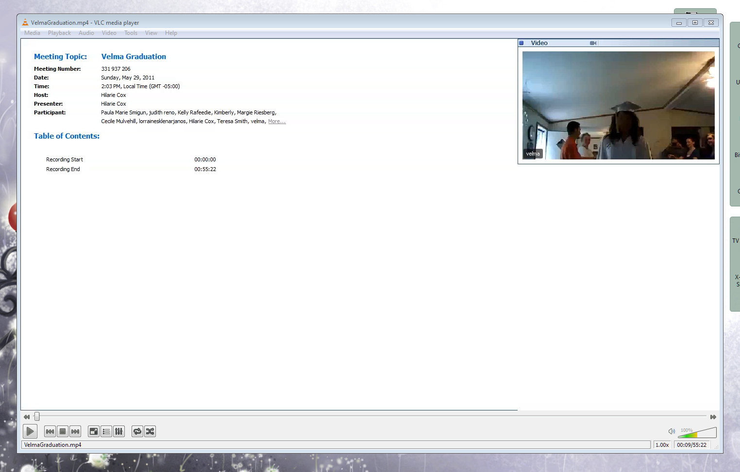

    The second file was an mp4 file which will stream or you can download by saving the page. If you stream this a bit you can quickly see the video on the top left. So this one is useless for streaming on a site. http://ringofspirit.com/velma/VelmaGraduation.mp4
