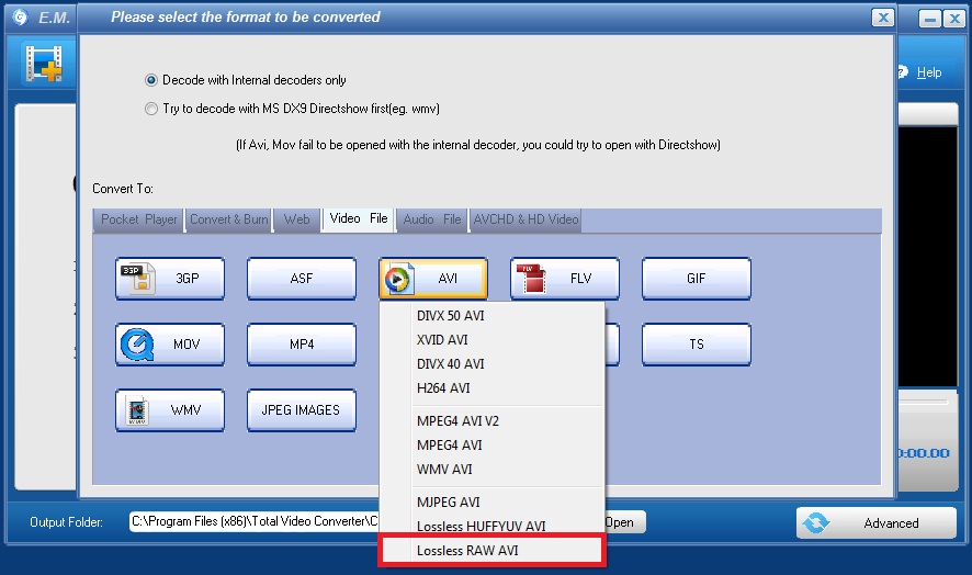

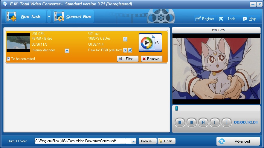

    Hi LeoHenrique,
    Are 2 methods for this. HARD (Saturn Emulator SSF + AVIUTIL) and EASY (TOTAL VIDEO CONVERTER 3.71)
    Both will work. You will get Uncompressed files + PCM.
    Try TOTAL MEDIA CONVERTER.
    if you want the SSF method, I can direct you to a forum where I put that in Brazilian Portuguese.
    Claudio
