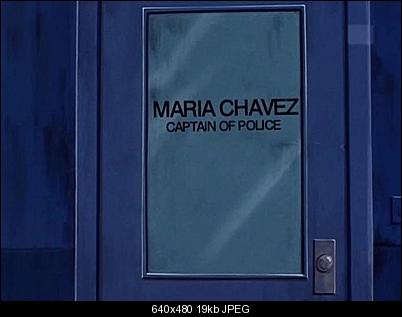

    I'm trying to remove a logo from the videos of some shows a friend recorded off a TV station. Unfortunately, these episodes are not available on DVD, so the only option is for me to use the videos she has. The problem is the logo is a solid color, which means I can't use one of the VirtualDub filters to restore the image behind it, like I could if it was a watermark. You can see the logo here to see what I'm talking about: http://i52.tinypic.com/24pw1l3.png
    It's that orange thing in the top-right corner of the screen. I want these videos to be the highest quality possible, so I'm not interested in just using another filter like X Logo, which will blur it away. I want to actually remove it completely, if that's at all possible. My friend has copies of the video in which the logo appears in a different location, so I was wondering if there are any filters which let you replace that corner of the screen with the video source from another file.

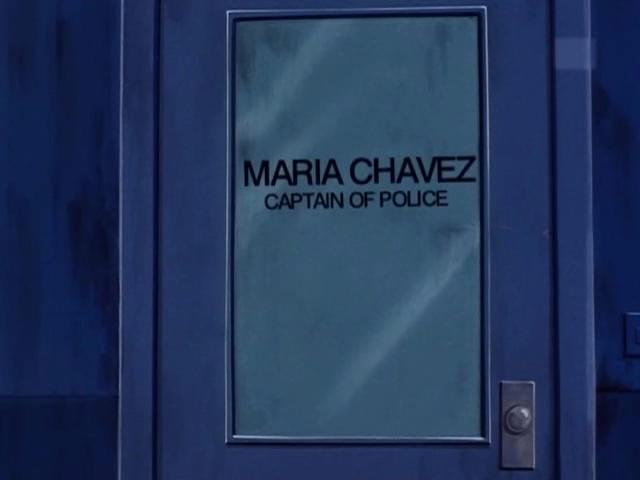

    I created an alpha mask the size of the overlay (48x40):
    In an alpha mask, black areas will be transparent, white areas will be opaque and shades of gray somewhere in between. The darker pixel in the mask the more transparent the overlay image will be.

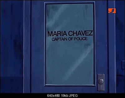

    Finally, the overlay is overlaid onto the first video using the alpha mask:

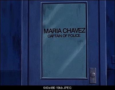

    The same script, minus the color adjustment:

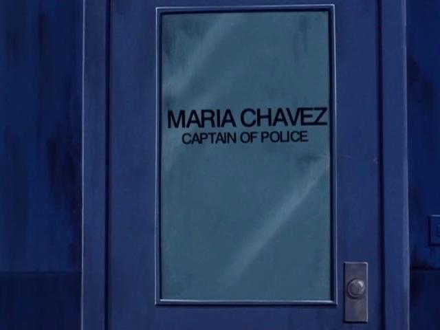

    As a reference, the original image with the logo:
