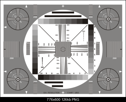

    I don't know where the "400 lines" comes from. IF your input is 720x480 NTSC or 640x480, etc., (or PAL formats), that's what the 8710 puts out....
    "400 Lines" of horizontal resolution is a classic measurement of analog frequency response as read off the vertical wedges of an EIA resolution chart. Nothing to do with pixels or scan lines. It is the point where alternating black and white lines merge to gray. 400 lines is about the limit of SVHS. Analog NTSC broadcast tops out around 330 lines of horizontal resolution due to 4.2 MHz luminance rolloff. VHS is around 240 lines due to 3 MHz rolloff. 704x480 4:3 ATSC digital broadcast resolves to about 540 lines of horizontal resolution. 704x576 4:3 DVB is similar.

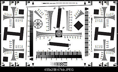

    PS: Some conclusions you can draw from this spec explains why 4:3 DVD at 540 lines of horizontal resolution looks so much better than 330 line NTSC broadcast even though they both are 480i. But 16:9 has a resolution cost. When you horizontally stretch 720 to ~853 for 16:9 wide, the center circle scales proportionately. So 540 drops by 720/853 to about 455 lines of horizontal resolution in wide mode.
    ISO_12233_chart

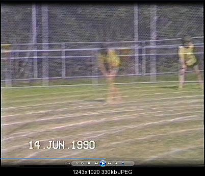

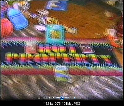

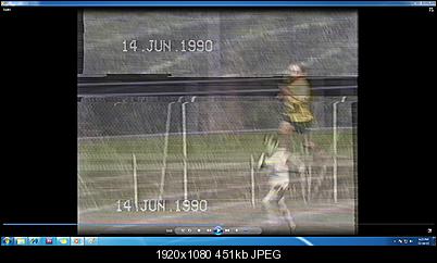

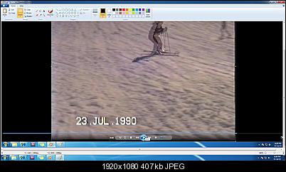

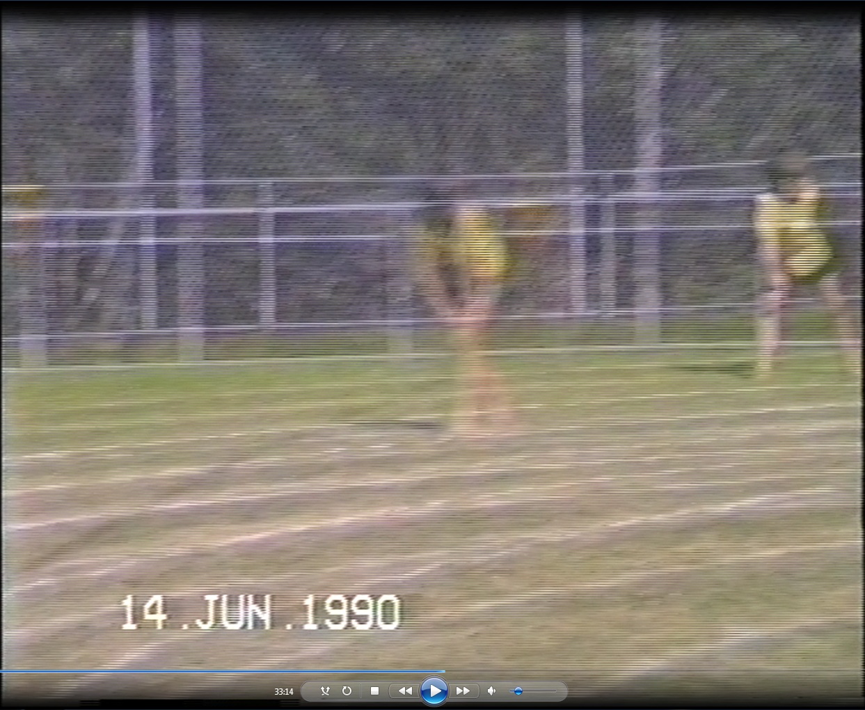

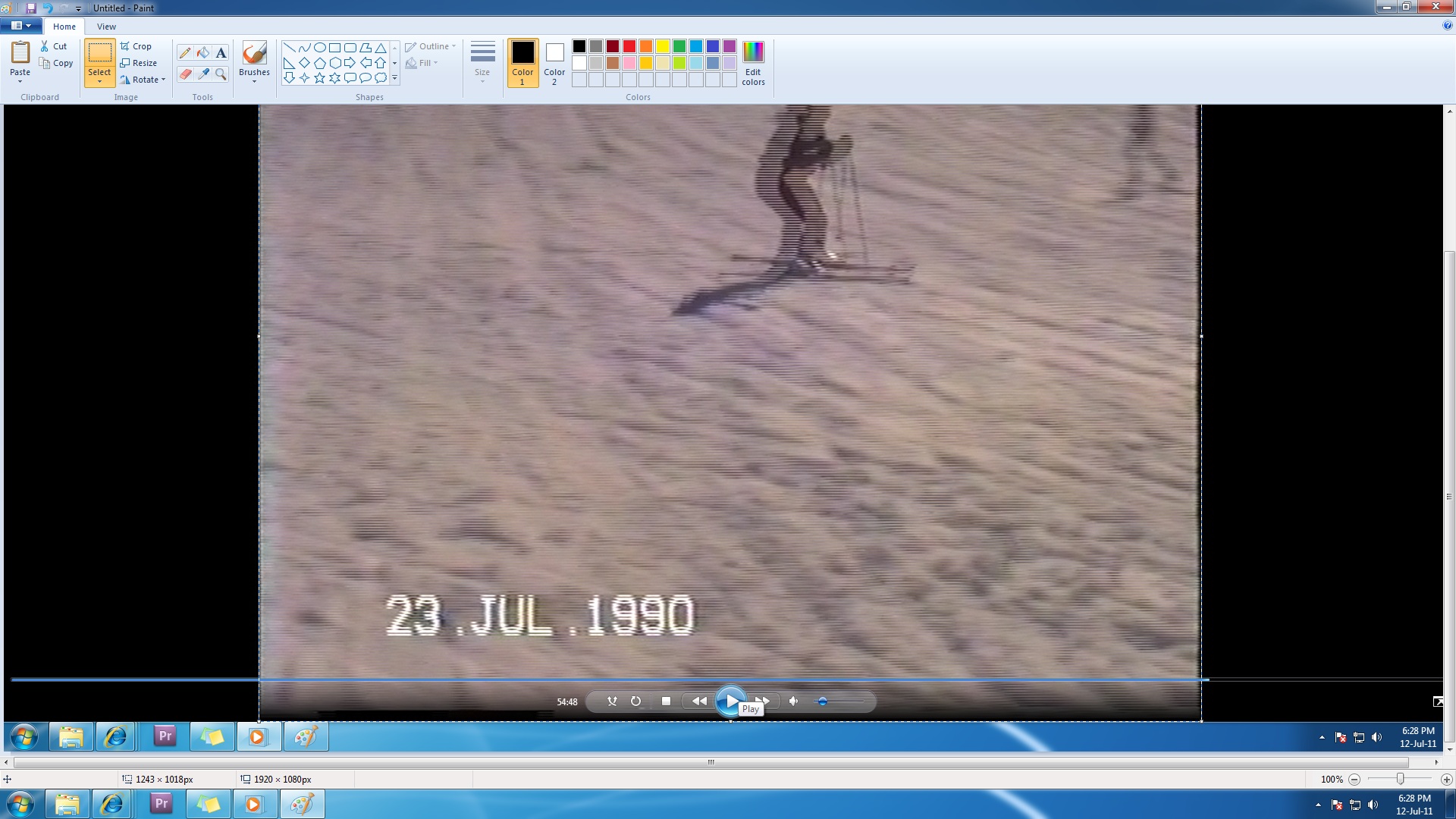

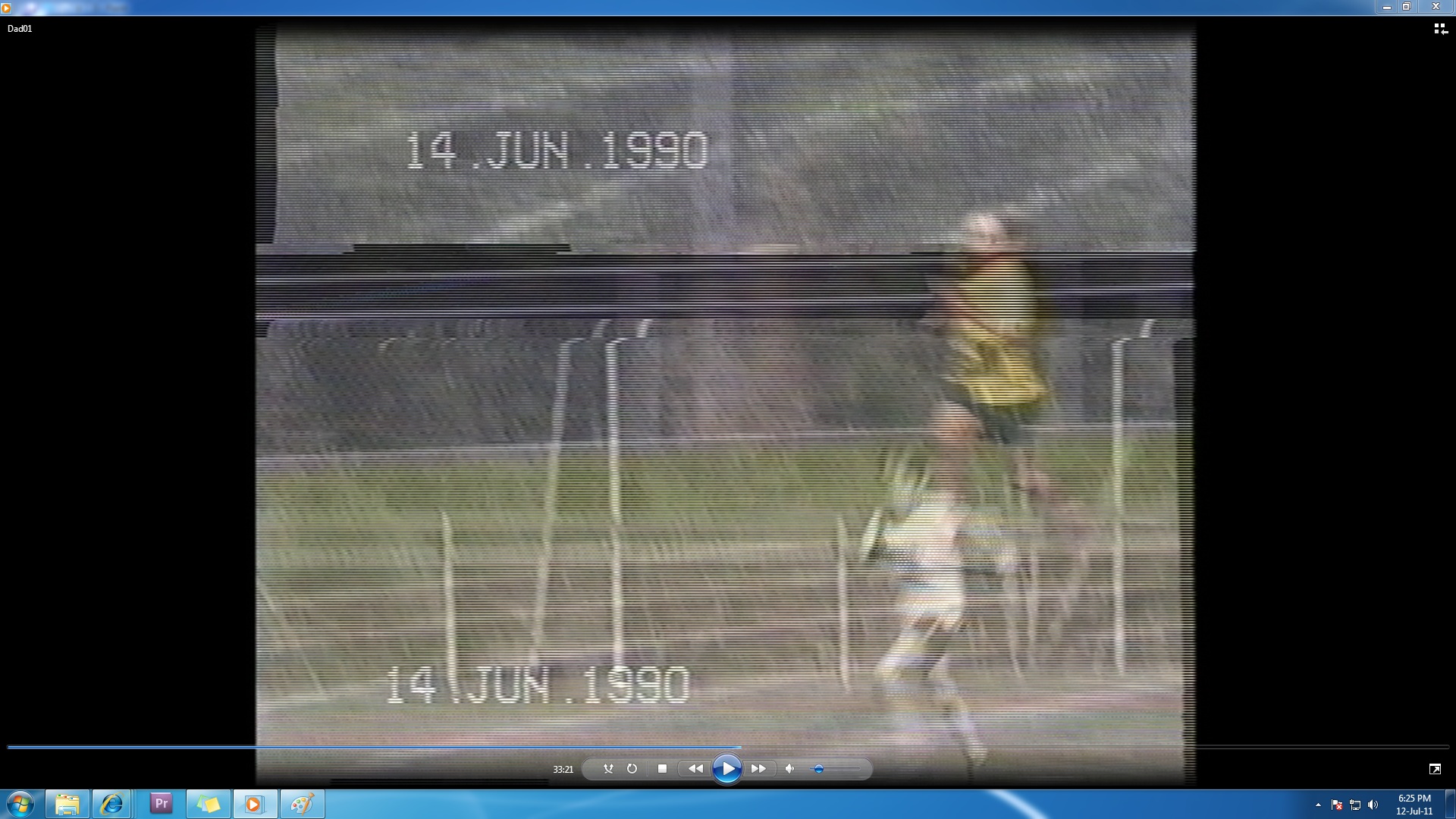

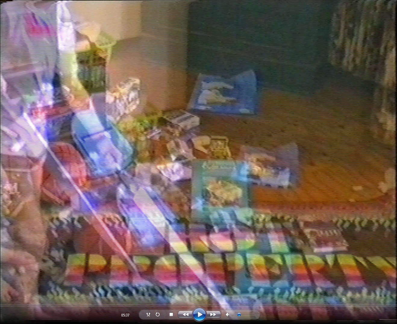

  19. Click image for larger version
ID:	7787Click image for larger version
ID:	7786Click image for larger version
ID:	7785Click image for larger version
    here are some screen shots
ID:	7783So it does not do this all the time but enough that it is way annoying and unwatchable!
    I personally thought it was the TBC due to the fact that before i used it the tape was uncapturable and now it is.,.. sortof
    and second due to some reviews saying:
    "A semi-con is that it doesn't just fix the bad part of the picture like more expensive TBCs, it freezes the entire frame, so when things get bad with your picture it will 'freeze' on the last good frame until it finds the next good one (like half a second later, usually), and your recording will have a 'ghost' image quality to it."
    I am now looking and asking around if a more expencive/prosumer TBC will improve my results or help.
    my chipset is Intel P67 on ASUS P8P67 Delux MOBO
  20. All your samples are showing loss of sync problems. I don't know the AVT-8710 so I can't tell you if another TBC is likely to do better. But it's normal for a TBC to freeze on the last good frame (or fields) when the signal is lost -- it's their job to provide a constant output signal even when the input is lost. Again, you should capture a known good source like broadcast TV or an unprotected DVD to verify the AT-8710 is working properly and your computer is capturing properly.
    Maybe you have a PAL/NTSC issue?

    These images look to me to have second generation kinds of lockup problems.
