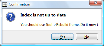

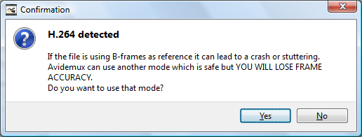

  19. Hi all,
    Sorry to dig this up but now that all is segmented and encoded I've been asked to host these on Vimeo or Youtube and there are issues. The video and audio start out synched but by the end of the video they are out of whack.
    Putting aside the notion that the advice given above was faulty, the only thing that I can thing of is that some of these videos were concatenated from 2 segments which were each encoded (as per above) and then appended together. When I did that I got 2 msgs (attached). I hit "no" to both because i have tried all possible combinations and nothing made a difference when playing on my computer.
    Can anyone think of any reasons why this is not working?? Why thing would start out smooth and then the audio would lag behind?

  20. I would use yes to that mode, and yes to rebuild
    Did you cut on keyframes ?
    Was it out of sync immediately after exporting? or only after youtube or vimeo processed it ? (i.e. when/where was the problem introduced)
    Maybe try a different build or Try a nightly build
    http://avidemux.org/nightly/win32/
    A better idea is to join them before encoding (ie. join the segments as mpeg2 before encoding to avc/aac/mp4)
