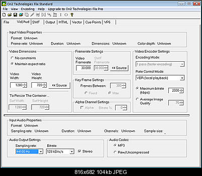

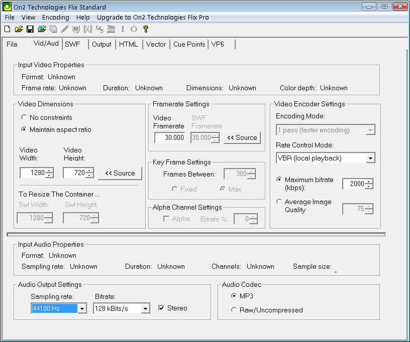

  6. Member budwzr's Avatar
    Apr 2007
    City Of Angels
    I use a Flix encoder.
    With this encoder, you can render to Flash anything supported by VFW.
