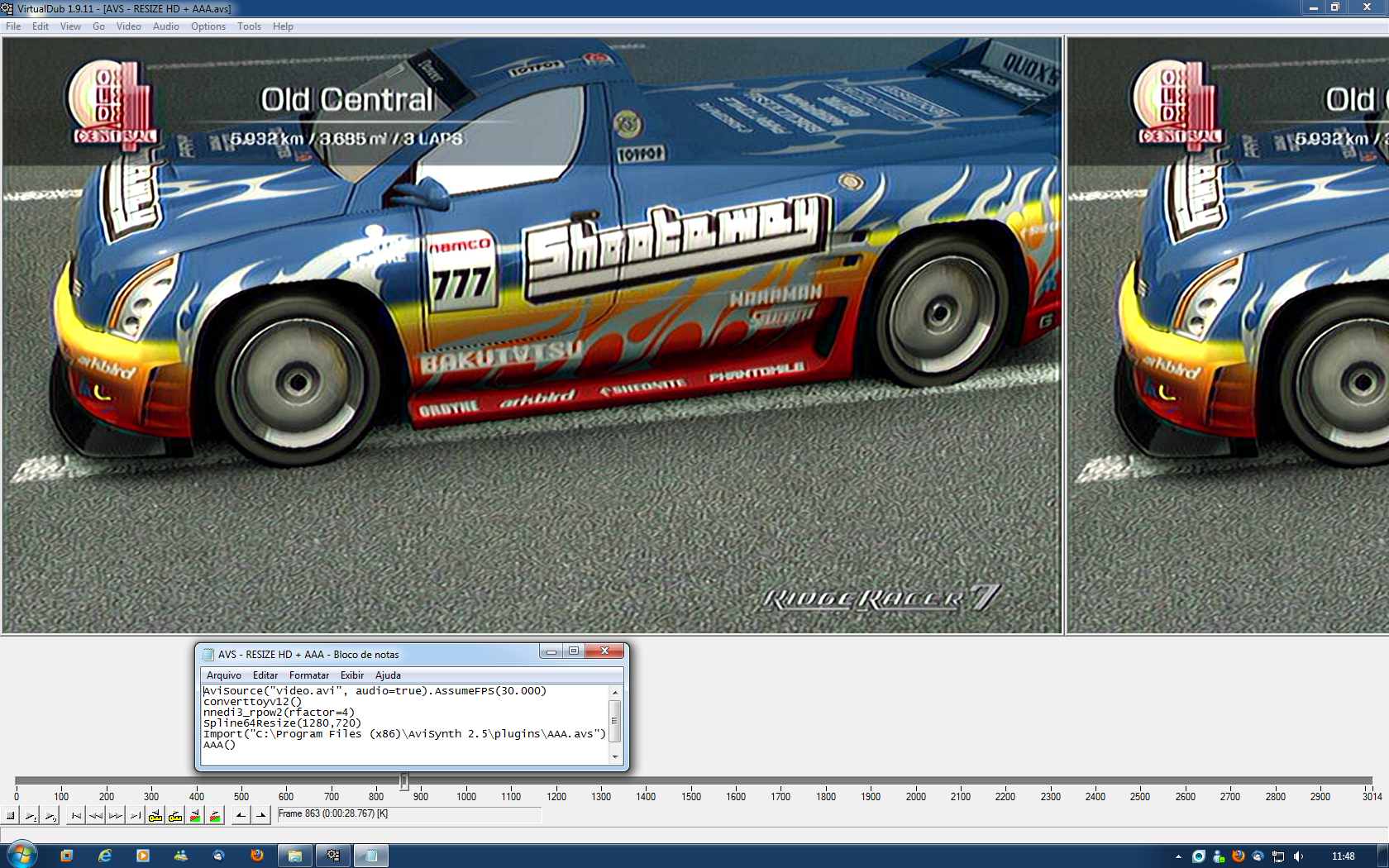

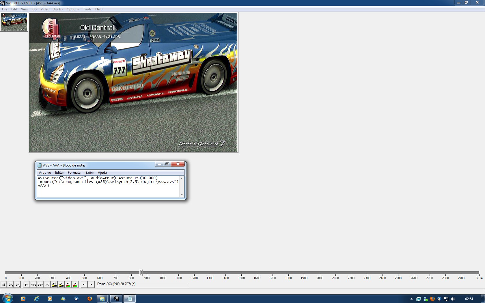

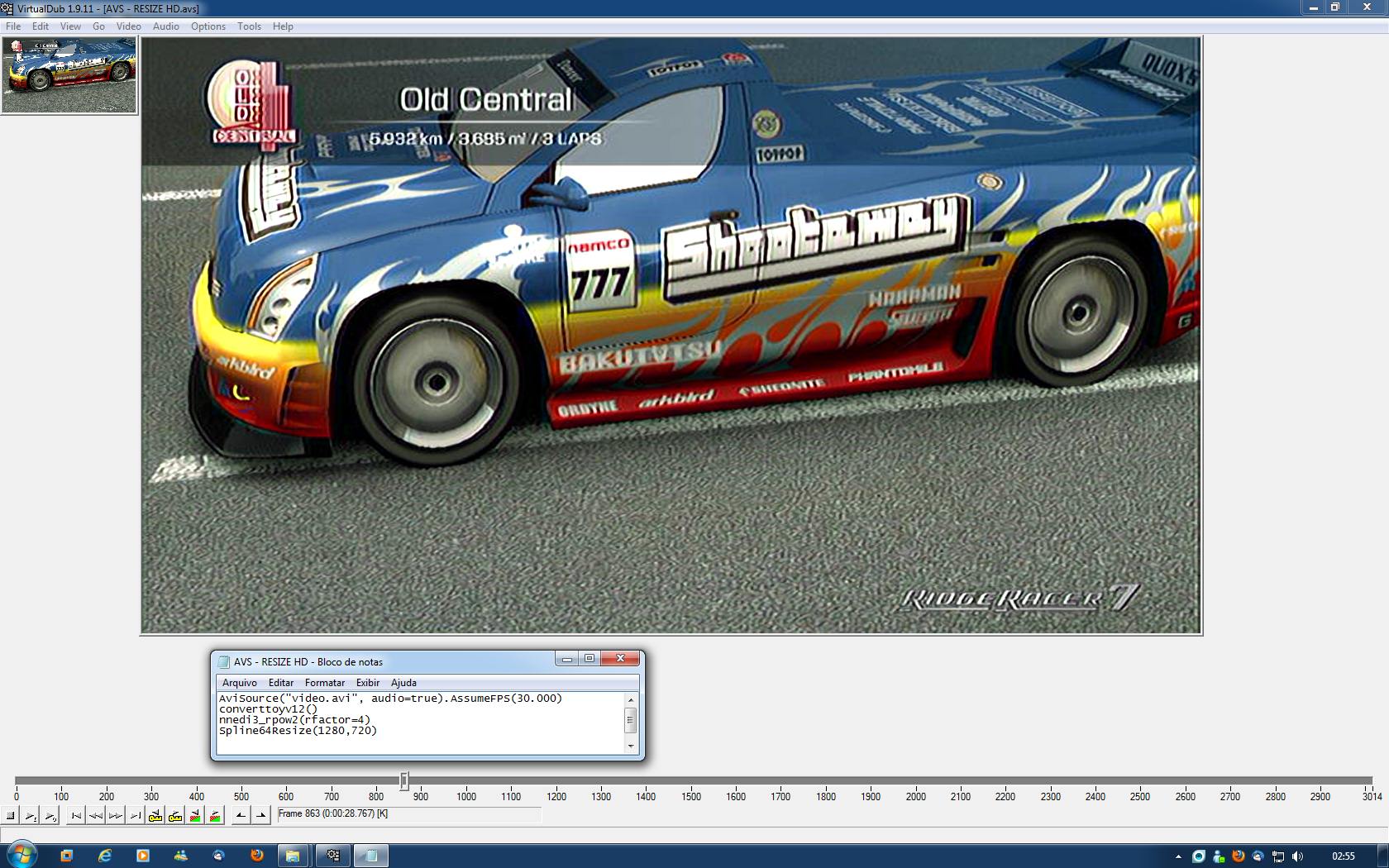

    You missed out the most important screenshot, the one showing us the script that's giving you the problem and the output it produces.
    No post because a gray screen only - no image.
    There's also a missing opening quote on the AviSource file name.
    copy and paste problem only.

  10. You didn't show the screen shot of the full script until after you had solved your problem.
    It was the same script as the first post Jagabo.
    The scripts were run separately worked, but did not work together. My doubt was to understand why.
