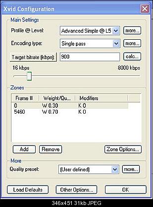

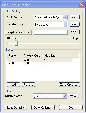

    Hi all, I'm not sure if I am doing this correctly. I'm using a single VOB as my source, using VirtualDubMod to Xvid avi.
    The first 4 minutes of the AVI are really blocky whereas the rest of the video is quite good (the subject is in motion).
    I thought I'd try using Zones to put a higher quality on the leading 4 minute segment of the conversion and resume normal quality for the remainder. So I have chosen a Weighting of 0.30 for the first part and I assume that the remainder will be 0.70 to give a total of 1.0 (100%) for the whole video file. Am I right in this approach? I just pulled this figure from nowhere really, just thought that 30% of the total would be dedicated to the leading part.
    Anyhow, it still didn't turn out any better.

  5. Originally Posted by peterhun View Post
    No, you're not right at all. 1.00 gives the whole thing equal weight based on the settings. If you want a certain section to have better quality than the rest (in your case, frames 0-5459), you use a figure greater than 1.00. The bitrate of the remainder will be adjusted downward (unless you also set zones for it) so that you come out in the end with the filesize you want. So, maybe set that first zone at 1.3 and set the rest for 1.00.
    By the way, the whole idea sounds a bit screwy to me. Ordinarily, most people want the video to have even quality throughout. I never touch the zones (unless it's to give the end credits lower quality) and usually do CQ encodes at a fixed quant (3, usually).

  7. Originally Posted by manono View Post
    That's the way it is in x264, a bitrate multiplier on the zone
    eg. So 1.3 would be 130% the normal allocated bitrate for that section
    But I edited my post after seeing this xvid guide
    http://www.divx-digest.com/articles/xvid_setup_page3.html
    The "Weight" option allow you to specify a weight on the chosen bit-rate. A "Weight" setting of 0.15 will mean the zone will only get 15% of the bit-rate of the main movie.
    I guess I was confused about term "main movie" in that article. In x264 , the multiplier applies to the zone, not a percentage of the main movie.
    So manono, you're saying it works the same as x264 ?
  8. I haven't checked the article, but 0.15 is often given as a figure to apply to a movie's end credits, distinct from the 'main movie'.
    I have no idea how x264 works, pdr. Sorry.
