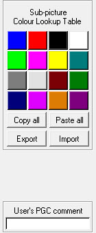

  5. I tried to export the .clb using Subtitle Creator (2.31) and importing into PGCedit (I tried both 9.2 & 9.3) unfortunately it did not make changes to the CLUT in PGCedit. I then tried Subtitle Creator version 1.92 and it looks like there is not "export palette" tool in this version??
    Anyway I changed in PGCedit the CLUT manually the top four colors (0=white. 1=white. 2=black & 3=dark grey) and the attached pic is what I ended up with. Better than the bright purple I had prior but this does not look so good to me. Does anyone know the assigned CLUT colors in PGCedit??

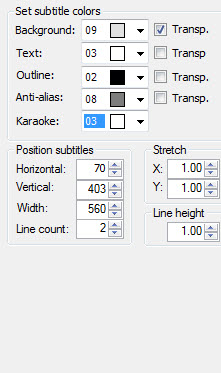

  6. So it looks like Subtitle Creator ver. 2.2 added the export palette option; opened my subtitle file in that version and exported the .clb (here were my settings in SC & the subtitle looked fine)

    Then I imported the .clb in PGCedit 9.3 CLUT and here is what it ended up with;
    Did not look right to me but I ended up going with it anyway & here is the final result;
    The top four colors, left to right, in Muxman are main color, anti-alias color, outline color, background transparent color. You're using them in the wrong order. Your main color has the purple 'leaking' through. I gave the order for the 4 colors when there's an anti-alias color being used, which is what I always use. It's different if you don't create an anti-alias color. It wouldn't take long for you to experiment and find the right combination. Or use DVDSubEdit until you get the hang of it.
    Although I use PGCEdit for this, and it takes all of about 30 seconds to accomplish, it's easier to understand what's going on when using DVDSubEdit for this work.
    The Clut picture you showed is just the default one. Nothing's been done to it. But the colors aren't being shown as mine are before I make the changes. They're in a different order. It must be something peculiar to SubtitleCreator. I use MaestroSBT for creating the subs for muxing in Muxman,

  14. Subtitle colours are difficult to understand because they are based on two things: the colours themselves, defined in the IFO CLUT, and that you can change with PgcEdit, and the colour indexes, defined in the subpic stream (and that you can change with DVDSubEdit).
    In post #6, we can see that the background colour is transparent, so we can ignore it. (BTW, the opacity value is also stored in the subpic stream.)
    The Karaoke colour is not used for standard subtitles, so we can also ignore it.
    The remaining 3 colours are colour indexes 3 (white), 2 (black) and 8 (grey). After importing the exported CLB in PgcEdit, they are correctly assigned to the colour squares 3, 2 and 8 (zero based). So, there is no bug in the import or export features of SubtitleCreator and PgcEdit.
    So, why is it possible to got wrong colours in the final subtitles? Maybe you have imported the CLUT in a wrong PGC. Of course, you have to import it in the movie PGC. Or, perhaps muxman has changed the colour indexes in the subpic stream when it has muxed it. I'm not sure.
    Take also in mind that you can change the colours of each subtitle individually in SC. So, perhaps you have assigned the muxman palette only to a specific subtitle.
