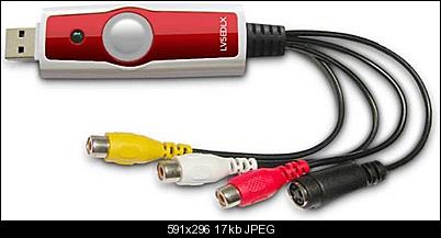

  1. I want to convert my OLD VHS tapes to digital format so i can finally discard them and save some space. Thing is, i want to choose the right equipment for this. There seem to be some all-in products, that include a cassette player, and can record directly to DVD, or store to HardDrive/USB Stick. These devices though also seem to cost like 200-300 Euro minimum so i dont have all this money to spend for something of such little importance as this.
    Although, I do own an Old Hitachi standalone VHS player that hopefully can playback this cassettes without chewing the tape, so i think i'll be needing for something to output the video to.
    My question is, how reliable are this PC accessories, and how well a job are they supposed to do?
    I found this for as little as 23 Euro, which is reasonable, but is the capturing going to be worth it?

  2. Banned
    New York, US
    The Hitachi player should suffice, if its transport is still OK.
    You need more than the device you showed in the post. Go here:

  3. What more? This is actually a receiver for video and s-video signals. Provided that my VHS outputs video signal i can use this device to capture it on my PC. The only other device i see on the link is something called a TBC, that costs 700-1000 USD which seems like crazy money...

    And to now answer the OP's question.
    Since you appear to be on a tight budget then the unit you show will be just as good as anything similar.
    The unit will come with some software. It may even be a cut down version of Ulead Video Studio which is quite a respectable piece of software.

  25. Guys i just saw these posts all at once. First Off just to settle this, I'm using Windows, not using MAC. So Windows software suggestions should suite my needs. I didnt think to mention this beforehand.
    What's more important here Software or Hardware
    ? I made this thread in order to get specifics on equipment and results based on hardware use, yet i kept reading messages about software and software techniques. I'm confused...

  26. Member DB83's Avatar
    Jul 2007
    The hardware is the most important but if you are on a tight budget you can try the low-end stuff which might suite your needs.
    Your profile shows Win98 but I suspect you have upgraded since then. If you are using XP then the device and software that comes with it should be fine. Vista is known to have some problems. I do not know about Win7.
    For your last comment, the simple answer is YES. No need to confuse you any more on that.

  28. Yes i have a computer with win 2k3 server a laptop with Vista, and a newer desktop with 7. OS and software selection is not an issue.
    I'm only wondering how the procedure differs between low-end and high-end stuff.
    For example how different will the results be comparing my 23 Euro device and the Canopus 200Euro that was suggested to me. Also how relevant are other Devices, like TBC and whatnot...?
  29. Member DB83's Avatar
    Jul 2007
    The proceedure does not alter. In every hardware capture device there is a chip that digitises an analogue source(your VHS) in to a digital one. The software uses that digital source to create a movie clip using compression - you could, theoretically, capture uncompressed if your PC was powerful enough - not the place to go in to that in detail as there are plenty of topics available.
    The Canopus device is more 'high-end' but it only does one thing - convert that analogue stream in to a DV stream. From that you can either use software such as WinDv to copy that stream in to a DV for use on your PC or use sofware to transcode the DV stream in to another format. If, again, you search the forum you will find people who love these units and people who hate them.
    But that really applies to any hardware. 'Best' is relative to your own experience. If you have only used one item then you have nothing to compare that with so it can be described as 'best' for you. On the other hand, if someone has used many different ones you can form a better opinion about what is 'best'.
    A TBC - Time Base Corrector - is quite relevent as a VHS source is by no means a steady stream. It may look fine on that tv since the transmission remains in the analogue domain but once that stream becomes digital then any flaws in the stream become apparent. The TBC works to correct those flaws.
