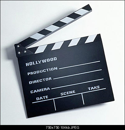

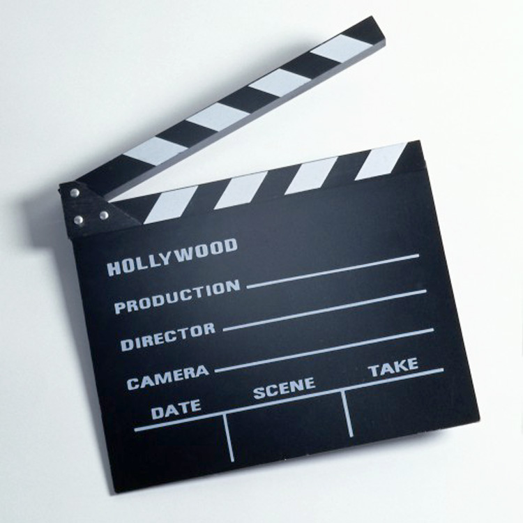

    BTW where do I get a clicker
    Sorry, no idea. I got mine from a parent after I promised to never bring it back to the kids as they were driving them crazy with it. It's a small metal kids toy, but it works well. Movie studios have used a clapper board that works the same to keep everything synced for quite a few years.:

    But two pieces of hard wood with a small hinge will work well enough. You just need a sharp, quick sound that is easy to spot in the graphic display of an audio editor. Even snapping your fingers will work if you can do that well. You just need a sound that you can record with the camcorder and your audio recorder at exactly the same time. Align those two and you are synced.
    Cut the video with audio off up to the click, then do the same with the separately recorded audio, save both with no compression. Then mux (Combine) the separate audio to the video and your sync should be perfect. Then you can edit as you like.
