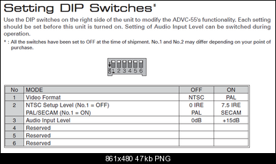

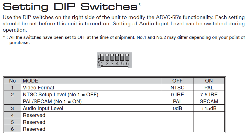

    The manual explains the dip switch settings
    http://static.highspeedbackbone.net/pdf/ADVC55.pdf
    Typical settings
    North America - OFF ON OFF
    Japan - OFF OFF OFF
    Europe (PAL) - ON OFF OFF
    Europe (SECAM) - ON ON OFF

  3. Originally Posted by edDV View Post
    [Attachment 12468 - Click to enlarge]
    Typical settings
    Japan - OFF OFF OFF
    All of my recordings are north american, so should I have mine set to
    1. OFF
    2. ON
    3. OFF
    4, 5, and 6 OFF

  5. Member edDV's Avatar
    Mar 2004
    Northern California, USA
    Typical settings
    Japan - OFF OFF OFF
    1. OFF
    2. ON
    3. OFF
    4, 5, and 6 OFF
    Yes. NTSC, 7.5% setup, 0dB nominal audio.
