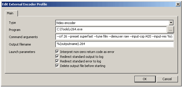

    Here are the profiles to create x264/aac flv with the external encoder.
    Video Encoder Profile
    (Program) C:\Tools\x264.exe
    (Command Arguments) --crf 26 --preset superfast --tune film --demuxer raw --input-csp i420 --input-res %(width)x%(height) --fps %(fpsnum)/%(fpsden) -o "%(tempvideofile)" -
    (Output Filename) %(outputname).264
    Audio Encoder Profile
    (Program) C:\Tools\neroAacEnc.exe
    (Command Arguments) -q 0.35 -ignorelength -if - -of "%(tempaudiofile)"
    (Output Filename) %(outputname).aac
    Muxer Profile
    (Program) C:\Tools\ffmpeg-git-c1daf07-win32-static\bin\ffmpeg.exe
    (Command Arguments) -i "%(tempvideofile)" -i "%(tempaudiofile)" -vcodec copy -acodec copy "%(outputname)"
Name:	External Encoder.gif
