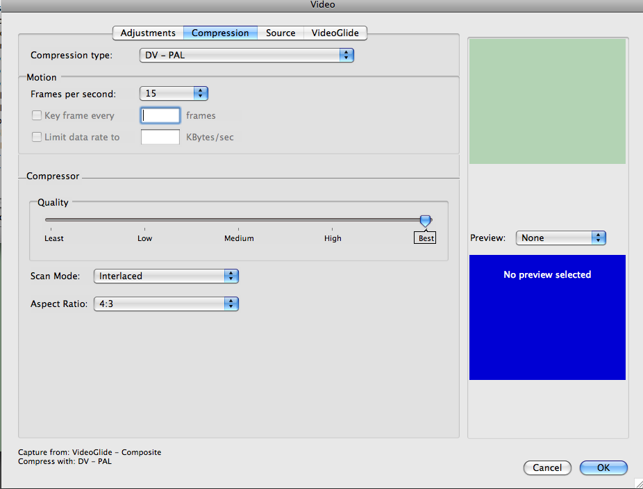

    What are the best settings for capturing a VHS on VideoGlide? I'm in UK, so PAL land.
    I understand 'PAL DV' is the best way forward, but what fps?
    I need to have an archive in the best possible quality of the original interlaced VHS footage.
    I will eventually de-interlace and compress for playback on computer, and make another format or use archive for TV playback or DVD. But before I can even start on any of this, I NEED to know what is the best format and fps to capture the VHS footage in top quality in the first place.
    I've done hours and hours of searching forums and discovered that DV PAL is the best format, but no mention of frames per second? not found the answer anywhere. I'm on a tight schedule so I'm praying someone here will know.

    Thanks for your kind replies. I'm not sure why I've made you angry, but I'm sure you have good reason. I apologise for whatever I've done to cause any upset or sarcasm.
    I understand that you think there is no option for frame rate under PAL DV, but there is in this software, hence my confusion. I'm attaching a screenshot. Please see the field for 'frame rate' under PAL DV, in "Picture 1" attached.
    In case it doesn't attach, please see the image here: https://forum.videohelp.com/images/imgfiles/l7XSZ.png
    I know that PAL is 50 fields and it's displayed as 25fps on television, but it's delivered to the television from the VHS as 50 fields. So, there-in lies the confusion. I'm connected to the VHS player via a USB -> composite lead. (S-video leads don't have a good result)
    What are the settings and frame-rate I need to select in VideoGlide for the highest quality captured footage?

    As I write this - sarcasm mode off - I can not see any picture. But whatever this software is trying to tell you then it could not capture DV in any thing other than 25 frames per second not for a VHS source.
    A VHS source does not display on a tv at 25 fps. Fps is a digital medium. VHS is analogue so it is 625 lines @ 50 mhz.
    I suggest you now give this a try. It may not even work since to capture DV the program may expect a DV source ie from a camera and not from the VHS

    Ok. I can now see the attachment. But even if the sofware allows this it makes no real sense to capture in anything but 25 fps.
    That is what I meant by 'give this a try'.
    But since my earlier comment I now see another topic where you have two devices - an ADVC and a usb gizmo. I hardly expect the sofware to capture correctly with the ADVC at anything but 25 fps. And as for the gizmo I do not expect it to capture in DV at all.
    So try both and report back.
  10. The software should not let you choose anything but 25 fps (50 fields) for capturing DV AVI.
    As mentioned, it not only asks for you to choose, it REQUIRES that you choose the fps. It doesn't mention fields anywhere, so it's a bit disconcerting; you don't really know what it's recording at, 25i, 25p, 50i, or 50p. I appreciate what you're saying but take a look at the picture I posted, you can also download VideoGlide and have a look for yourself if you don't believe me

    Ok. I can now see the attachment. But even if the sofware allows this it makes no real sense to capture in anything but 25 fps. That is what I meant by 'give this a try'.
    But, I can 'try' anything, I'm asking what's the right thing to do. I'm only going to get one chance at this, then I have to catch a train. It captures at any frame rate I type in. What I don't want is to discover in a year's time that it hasn't captured each field distinctly. I need an archival copy so that I can edit in the future.
    Ok, so I'll type in "25" in the fps field then if you think that's best? You sure it'll record at 50i?

    Do not over-complicate the issue. Capture devices often will allow you to select different frame rates. But if one of your goals is DVD it would be madness not to stick with 25 fps.
  14. Originally Posted by matt9b View Post
    Since the software shouldn't let you capture anything other than 25i when capturing as PAL DV nobody can be sure what the software is doing. Enter 25 as the frame rate and in all likelihood it will be 25i because all analog PAL video sources are 25i. Why don't you just capture a few seconds of video from your source and see what you get?

    But this is what I've been asking. For no recompression, no transcoding, and correct fps, correct field order, correct number of fields for VHS PAL50 tapes, what is the best setting in VideoGlide for this?
    PAL DV is always 720x576. From VHS deck it should be captured at 25 interlaced frames per second.
    I assume by 25 interlaced frames a second you mean 50i, that would be correct. But this is basically what I've been asking all along - what setting do I need to click on to achieve this in VideoGlide?
    compress with a lossless codec like HuffYUV. Captured at 720x576 or 704x576, 25 interlaced frames per second.
    Thanks, but I know this already. The question is how do I achieve this in VideoGlide? i.e. what button where do I press? lol! I must not be communicating correctly. This thread isn't a theory question, it's a software question. What button do I click in VideoGlide to achieve the best setting for VHS ( i.e. least lossy compression at 50i )?

    If I read it correctly, videoglide will only capture at a maximum of 640*480 whatever compression you choose.
    My friend above explains that 640*480 is not optimum so you will end up re-encoding which means a loss in quality unless you can choose a lossless codec such as HuffYuv or Lagarith. Whether either of these are availbale for the Mac I simply do not know.
    Now if you want a 'Videoglide guru' to get involved then I suggest you post another topic with a good descriptive header in the Mac forum as all the topics you posted so far are intended for Windows users.

    Now I already thought I explained the function of the ADVC - Analogue (to) Digital Video Converter. To clarify, inside the unit is a chip with a hardware compression codec which is pure DV or in simple terms 720*576 at 25 frames per second. Software does not need to do any additional conversion so you end up with a 720*576 at 25 frames per second DV. If you choose anything else then it is not pure DV.
    Videoglide, it appears, is incapable of providing that even if you select 25 frames per second. We simply do not know what compression settings Videoglide will provide for - it talks about 'High Quality'. Even 'better than DV'. Now if we can see just a small sample we can get a better idea of its capability.
    So just do this. Select DV. Select 25 frames per second. Make a small clip from the usb device and another from the ADVC and make them availbale. It is not rocket science surely. You could even take this ferther and tell us what other compression options exist and even make some clips for these.
