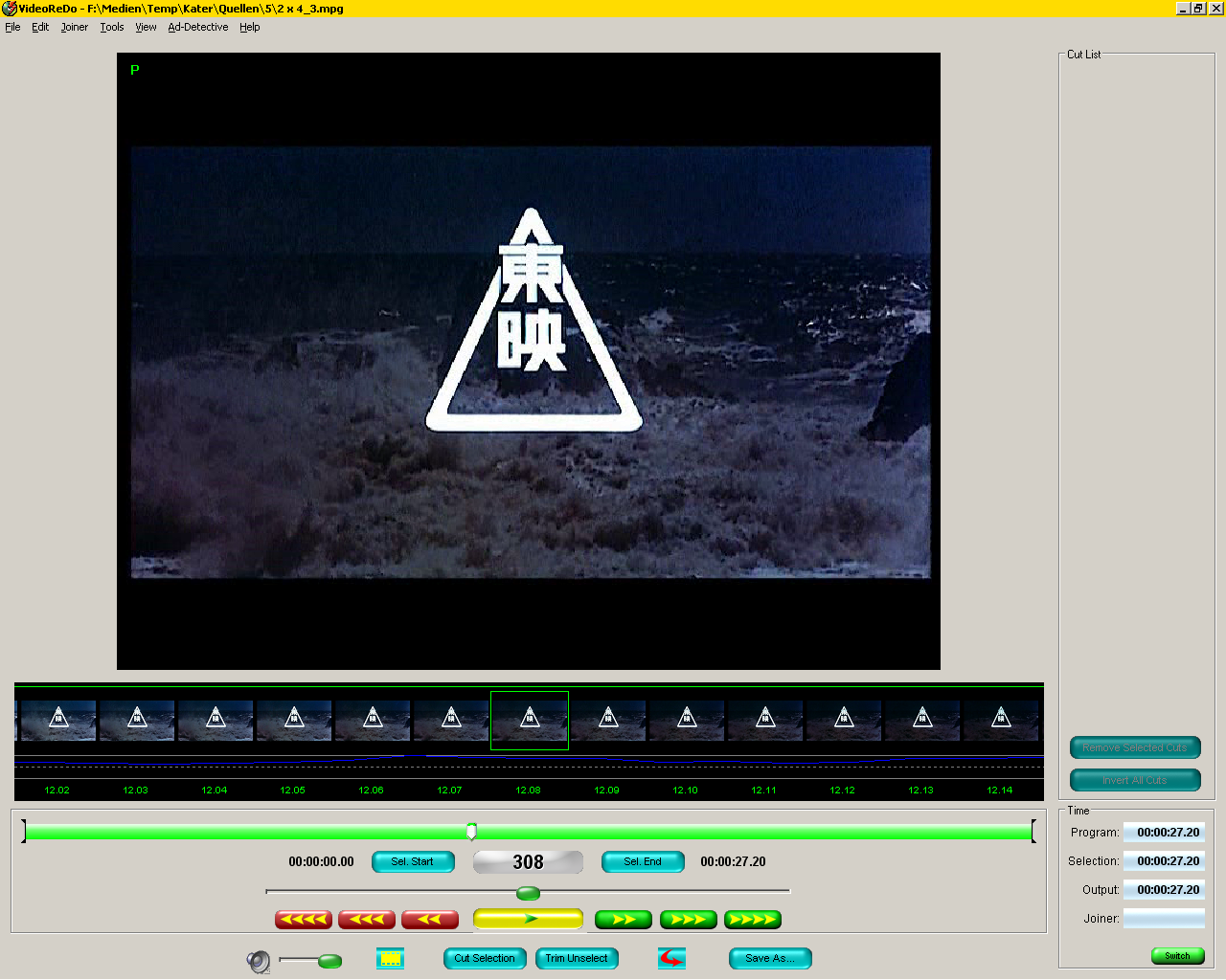

    Well, in the japanese letters the interior is not dark (as it should be), but also
    almost completely white. As if you increase the contrast too much and the light colors all become white.
    See image 1 vs. 2.
    The original clip you will find at http://www.mediafire.com/?vo74tjlex6olci2 (12MB)
    and the other clip at http://www.mediafire.com/?vsqcdlshdum99d8 (20 MB).

  26. Originally Posted by kotyczka View Post
    So I cannot tell anything about the frame jumps you mentioned. Maybe it was
    converted from NTSC to PAL?
    This clip http://www.mediafire.com/?vo74tjlex6olci2 has both missing and duplicate frames. This clip http://www.mediafire.com/?vsqcdlshdum99d8 doesn't. The first clip also has blown out brights and darks, is much blurrier, and has different colors. I hope the rest of the movie isn't like the first clip.
    Jagabo is correct. There is a missing frame is beween 49,50 and there are duplicates at 36,37 ; 52,53 ; 60,61 ; 84,85 ; 109,110, 133,134 ; 158,159 ; 207,208 ; 255,256 ; 280,281.
    I don't know if this piece has audio (maybe there is waves crashing ?) , but I can delete the dupes. This will look better (less choppy) but will change the timing. If the audio is unrelated, then you can probably remove the dupes without problem, or even insert longer black fade in/out.
    I can even generate a missing frame for you to fill in the gap
    In retrospect, it might have been better to start with the 1st part of the 2nd clip, but I didn't even look at it. The levels are better, but it has other problems with a shifting logo, pixellated logo fade out, more macroblocking in the waves (macroblocking not really worse in this case, since the other clip has the waves partially blown out and there is less detail there to begin with)
    EDIT: here is the clip with dupes removed, missing frame filled in (interpolated), open GOP. If you really want closed GOP, I can do that
    Cheers
    No, the rest of the movie is of MUCH better quality.
    That would make it perfect (removing double frames, filling missing frames).
    However there is audio. This video had DD2.0 audio, but there was another source with weaker video but better audio (even DD5.1). I got it managed to get this video and the other audio synchronized. The audio files are already finished, I would not like to touch them any more. Therefore the intro clip should be excatly 337 frames. If some duplicate frames will be removed (about 9 or 10) I would just add as much black frames at the end of the intro. The triangular logo will fade earlier then, but that will be OK.
    And yes, please with closed GOPs. The rest of the movie is encoded with a average video bitrate of 8500 kbps (the whole movie is only 52 minutes). I hope with such high bitrates the disadvanteges of closed GOPs will not be too bad.
    Would be really great. As above, closed GOPS, overall 337 frames (filled with black).
  29. Closed GOP , removed dupes, filled missing frame, extended fade out, 337 frames
