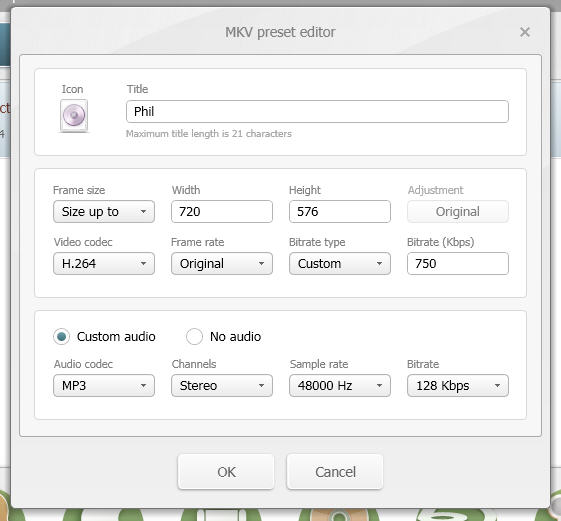

    I use Freemake Video Converter for this. Convert the .ts to .mkv & create your own profile where resolution is 'upto 720x576', h.264 video codec, use a custom bitrate of 750 & output the audio to MP3 @ 128k.
    This will bring a 12 GB-ish capture down to around 500-700Kb with pretty good quality. If you aren't happy, experiment with different audio settings & a higher bitrate.

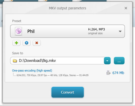

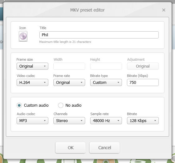

    To select a different resolution, change the setting in 'frame size'. To leave it as per the source file, select 'original' as shown in the attached pic. The last screen where you hit 'convert' will show you the estimated output file size & it will also allow you to select either 'one-pass encoding' or 'two-pass encoding'. One pass is quicker (about half the time of two-pass) but two-pass gives a better quality result.
    You may indeed find that 750kbps isn't good enough for you & that's why I put that caveat in my original post. I found via experimenting that the quality of h.264 .mkv files coming from Freemake (either from SD or HD DVB captures or a DVD as the source) is pretty good, better than from some other transcoding software, but in some cases dark scene artifacts do creep in. I found increasing bitrate didn't have much effect in reducing them, but did make a big change to the output file size. Maybe that's a function of Freemake's transcoding engine & it might not be the case with other software.
