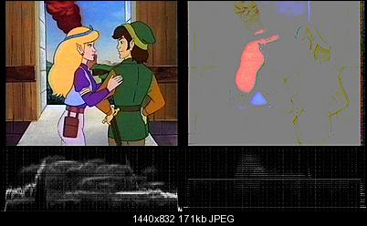

    Look at the two images I just posted, of the girl and the guy. In the original (top image), luma in the the capture was almost just right -- which is tough to do with VHS because it's so variable from scene to scene. The colors were complicated, so I had to do that in RGB. But if you check the darkest parts in YUV before going to RGB, you'll see the back of the guy's hair is just about RGB 9 or so, and furniture in the background has details that are just beginning to disappear in the dark. I raised luma just a matter of a few points (ColorYUV(off_y=4)), which was just enough to bring a little more detail out of the darkest stuff and keep shadows from looking gummed up.
    In the movie, the scene is a dimly lighted interior, so I didn't want to make the darks too bright. Ruins the mood, y'know (picky, picky).

    I wasn't referring to luma range, but to colors. The histogram I posted is an RGB histogram from VirtualDub. Overall luminance is at the top, followed downward by Red, Green, Blue. Overall luma was OK. Red and Blue were stretched across the right and its brightest values (at the far right-hand edge) would have crushed (washed out) significant detail if any had been there. As I said, with anime it usually doesn't matter. But I have seen plenty of anime with blown-out highlights. In the RGB histogram, the left-hand edge has a few peaks, but those are from your black borders. Black borders will always lie against the left-hand edge (darkest colors or luma) of a histogram.
    3D-DNR doesn't address the kind of damage I showed. It deals more with chroma noise and luminance noise. I couldn't find a video example of that noise, but I did find a still-photo site with examples of that same noise as it appears in digital cameras and still photos. But it also occurs in video (especially in tape), and it's the same kind of noise. http://www.cambridgeincolour.com/tutorials/image-noise-2.htm . The "bristling' or simmering and dancing, streaking grain you see in your clip is chroma and luminance noise.

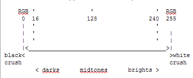

    Decrease contrast = -->>---->---->|<----<-----<<--
    Increase contrast = <<----<------<|>------>----->>

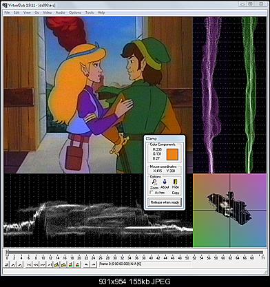

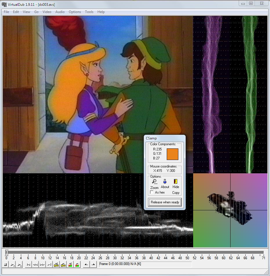

    You should learn to use the VideoScope() filter. Also, if you don't have it, get CSamp. It's great for reading RGB values off the screen.
    CSamp on top of VirtualDub displaying your video and VideoScope():
    I cropped away the black borders to concentrate on the actual picture. Note that the Y graph (on the bottom) is nowhere being too low or too high. It's easily between about 40 and 160. In all likelihood the contrast should be stretched to bring the darkest areas down near 16 and the brightest areas up near 235. But you can't judge by a single shot. You need to examine the entire video (unless you plan to adjust shot-by-shot).

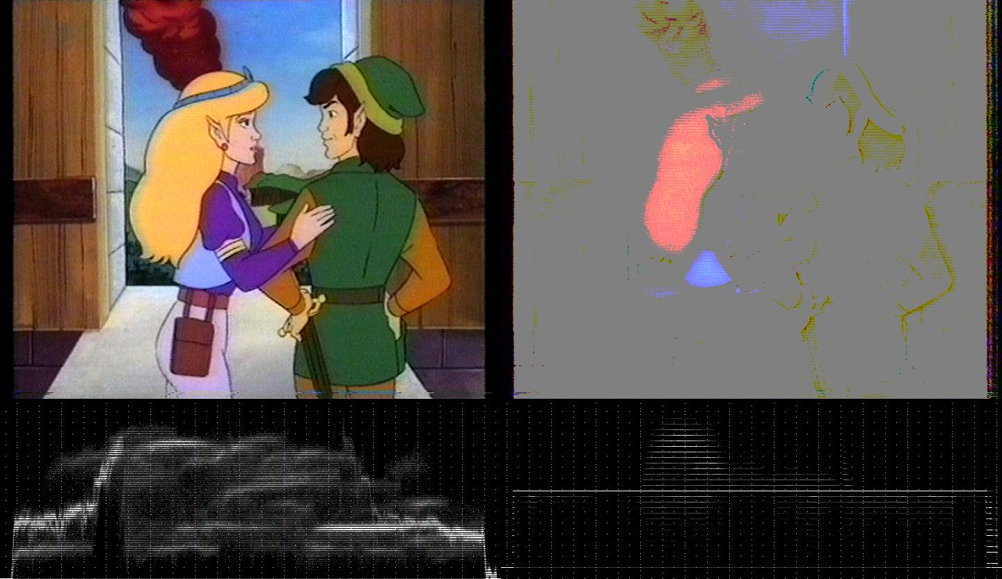

  8. One way to check for illegal YUV values is to convert the video from YUV to RGB, back to YUV and then subtract from the original. Illegal YUV combinations will not survive the conversion intact:
    AviSource("ds003.avi")
    ColorYUV(off_y=-35, gain_y=150) # brighten it up to create illegal colors
    diff = Subtract(last, ConvertToRGB(last).ConvertToYUY2()).Levels(112,1,144,0,255)
    return(StackHorizontal(last, diff)).VideoScope("bottom")
    Levels() is used here to accentuate the differences.
    Anywhere that's not medium grey has illegal colors.

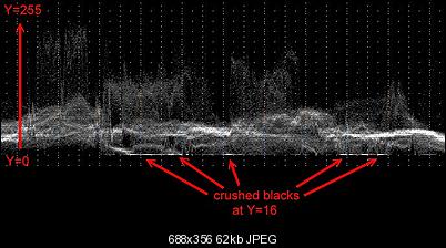

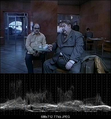

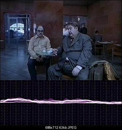

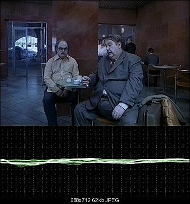

  13. U and V need to be between 16 and 240. But just knowing that doesn't help much -- not all combinations of Y, U, and V within their respective ranges are legal.
    If you're going to be filtering, you don't need to worry too much about whether the values are 100 percent legal. You can correct them later. As long as they aren't crushed at the bottom or top.

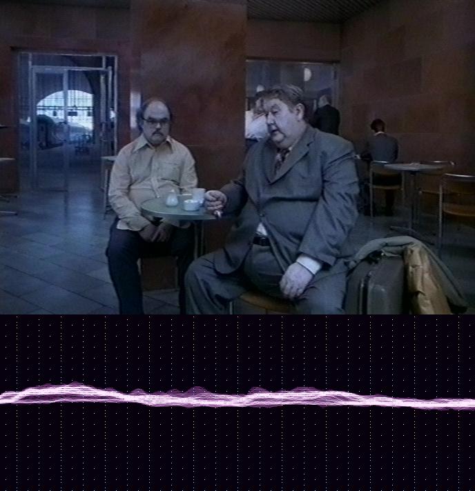

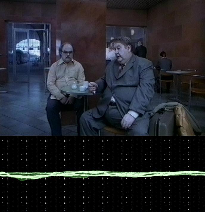

    Your last cap has luma crushed at Y=16. Notice there is nothing below Y=16 and there is a solid line right at Y=16:
    Y:
    U:
    V:
  14. Your last cap has luma crushed at Y=16. Notice there is nothing below Y=16 and there is a solid line right at Y=16:
    Donīt see the solid line, you mean the white noise stuff below, they just stop at the edge on both right and left doesnīt it?

  15. Originally Posted by zerowalker View Post
    But here i did an adjustment, does this have legal Y?
    EDIT:
    Oh do you mean at the bottom of the white noise?
    If so, then i totally see it.
    I guess "solid line" is a bit of an overstatement. The bright horizontal line segments at Y=16:
    The implication of those bright lines is that parts of the picture went below Y=16 but the capture card or settings crushed them up to 16.
    By the way, I cropped away the black borders to make sure we were looking at the picture content, not the black borders.
    ds004.avi only has a tiny amount of crushed blacks at Y=16.

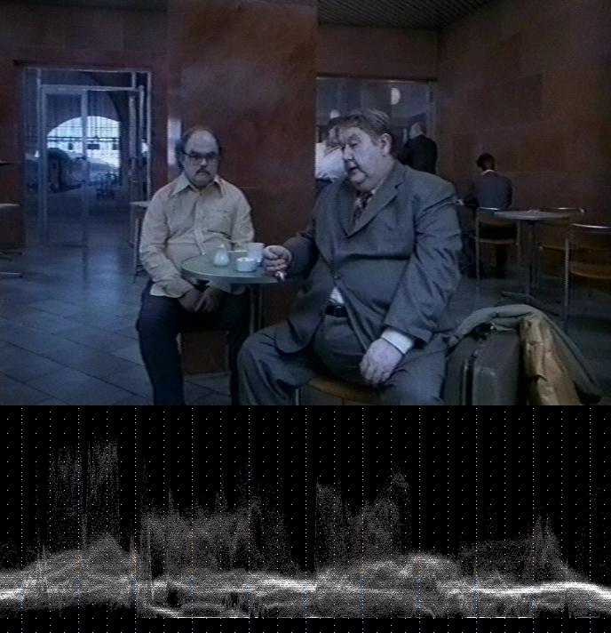

    You did a little better with Y levels, just needed a tiny nudge upward, maybe 10 points. The scene itself has a very odd color balance; contrast looks too thin, which would lead you to expect a "bright" image. Yet it looks rather grim. But here is an image that might let you understand what is meant by "crushed" darks:
    (original, frame 64 of ds004)
    [Attachment 13613 - Click to enlarge]
    Look at the darkest colors to get idea of suppressed shadow detail. Try the young man in the dark suit, standing behind the two older adults. What color is his suit? Blue? well, not really blue because there's some other color in there. Red? Hard to tell? It sure is, because lume itself is creeping into crush territory and red is depressed down there. The other problem can be seen from the hospital sheets and gowns. Shouldn't they be white? Maybe this hospital has cyan sheets and clothing (blue+green). Look at the older woman's hair; is it blue? (As a matter of fact, it's mostly blue). It's a little hvague to indentify hair and skin color here, because there is so much blue in the picture.
    [Attachment 13614 - Click to enlarge]
    Start with ColorYUV(off_y=10), or off_y=15. "off" is an offset that shoves y to the right, into the brighter area, here by 10 or 15 points. Work with other colors later, as off_y will usually bring other colors up with it.
    The rest is fiddling with colors in YUV and RGB. The young man is wearing a brown suit (and now you can see the detail of his lapels). The young woman's hair is red. This pretty much has to be the case, because if the sheets are made white, and gowns white, and the shadows in the garments are closer to gray, and the old woman's hair is gray, and the blacks are really shades of black, then the other colors fall into place.

    It's possible that a capture device is too dark at its default settings, so some adjustment might be needed. However, every input source will have its own problems as well. So you'd have to make a quick check with each source. You likely can't use exactly the same settings for every source. It's not that your capture has changed; it's that your source changes.
    Then the White Crush is what makes Bright placed look gloomy,
    White crush wouldn't mean your video is too dark. It usually means contrast is too high (the brights are too bright). Black crush occurs at the opposite end of the spectrum: dark colors are too dark.
    i have very very hard time tweaking this, as i donīt know where itīs supposed to be. I only tweaked it so that a certain picture which totally "Whitened" the image so much that you barely saw anything got good. Itīs adjusting automaticly while playing, and by default, it canīt handle fast changes to white, it takes a long time for it to adjust, so i changed it a bit, donīt know if itīs to harsh though.
    AGC should never be used during capture. A big problem. There's no way to fix its effects after capture.
    You should learn to read histograms. You can also "eyeball" the captured image, but histograms are easier and more precise. How To Use Histograms shows examples. The histograms shown are RGB types, but the principles can be observed with various histogram styles in Avisynth and VirtualDub. There are also photos that show how various problems appear.
