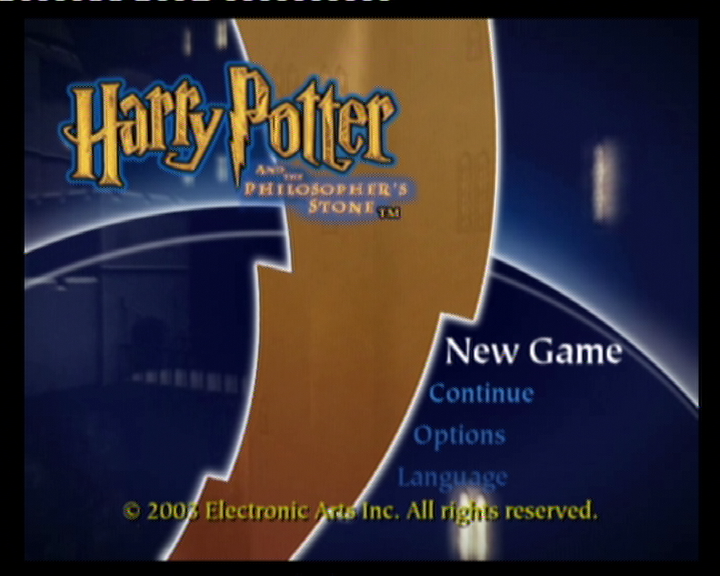

    I will upload a clip, please tell me what you think
    Check the noise around the text with blue aura "Philosophers's Stone", i think itīs the capture card that isnīt the best, though my thought has many times been wrong.

  16. Did you capture that via composite or s-video? That's pretty much normal for composite video capture. Only a few cards have 3d comb filters that will remove those dot crawl artifacts in static areas. Like the ATI 650 and 600 capture devices.
    Why is your video 720x417? Did you resize it?
  17. Itīs Composite, but that isnīt Herringbone(ground loop?), meaning, either pictures or video.
    So S-video is better for dot crawl?
    /Read about it once again to cofirm, yes it does;D

  18. Originally Posted by zerowalker View Post
    No, that's dot crawl. Herringbone would be all over the image, not just around the edges of colored areas.
    Dot crawl comes from incomplete separation of chroma and luma from a composite signal. S-video keeps chroma and luma separate so you don't get that crosstalk. Unfortunately, some devices with s-video output produce that s-video from a composite signal with a cheap circuit -- so the s-video output from those devices has dot crawl.

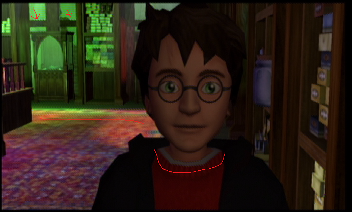

    Oh, i see, had herringbone in the picture i showed before (with red arrows) right?

  20. Originally Posted by zerowalker View Post
    Herringbone refers to any noise that has a herringbone-like pattern. It is usually caused by some kind of external noise source. The noise in your caps are all dot crawl artifacts. They only occur at the borders of different colors. Large areas of a single color don't show dot crawl artifacts -- and your caps aren't showing any .

  21. With Red Arrows, i meant my old picture, the one i had resized, caused it showed so well than, but glad there isnīt any on these
