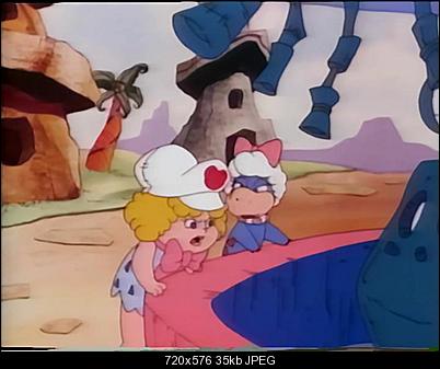

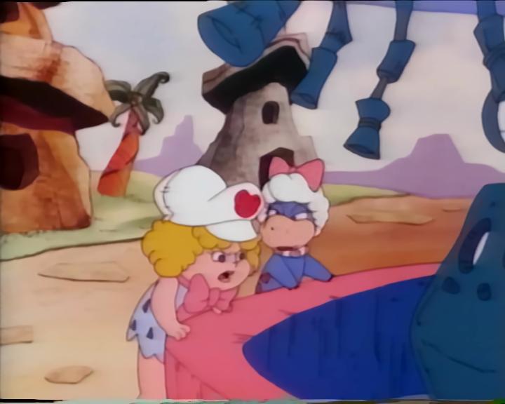

    Here's the same frame as earlier but with some noise reduction and sharpening:
    I added this to the earlier script:
    TTempSmooth(maxr=5, lthresh=20, cthresh=20, strength=5)
    Deen()
    DFTTest(sigma=32,sigma2=32)
    AwarpSharp2()
  4. ah very nicely
    Will play around with it!
    Ah okay, thought it changed to digital with the wires, cause that doesnīt sound to good, as analog isnīt any "form" if i get it right, just signals.
