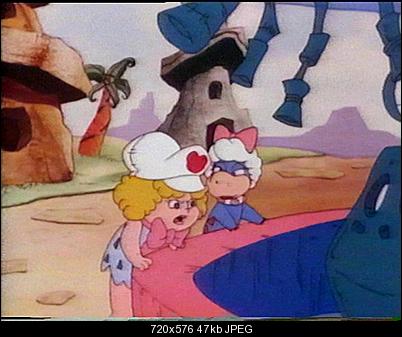

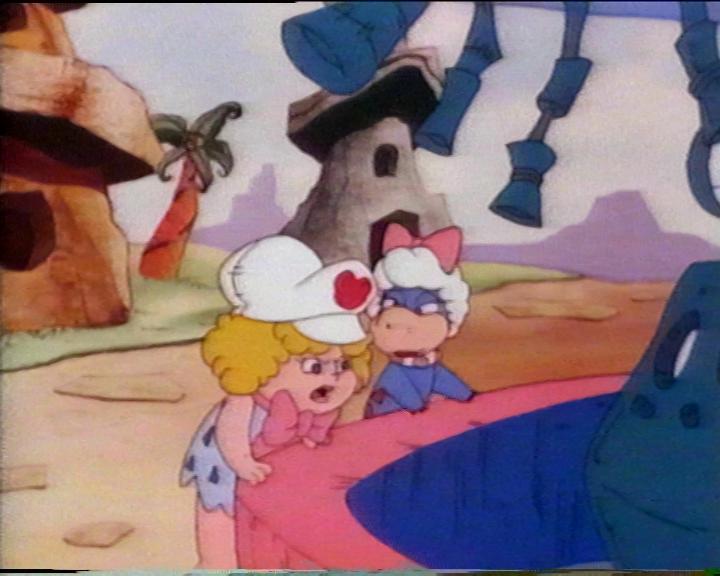

  29. I still don't know exactly what the problem is but here's a workaround for the green and red stripes:
    AviSource("delayHUFF.avi")
    AssumeTFF()
    # blur the chroma channels vertically to remove the stripes
    # but keep the original luma channel
    MergeChroma(last,BicubicResize(width,height/4).BicubicResize(width,height))
    # restore the original 23.976 fps, eliminate most of the field blending
    Yadif(order=1, mode=1)
    SRestore(frate=23.976)
    ChromaShift(C=-4, L=-2) #shift the colors left by 4 pixels, up by 2 pixels
    ConvertToYV12()
    MergeChroma(awarpsharp2(depth=48)) #sharpen the colors
    ColorYUV(off_u=-4) #adjust the white balance -- make the girl's hat white
    ColorYUV(cont_u=50, cont_v=50) # increase the saturation
    Now the video is ready for some noise reduction. But there is some chroma blending left.
    I'm still looking into a real fix for the color stripes...
