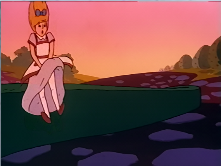

    Edit: what is the best way to prevent this weird looking thing (look under the girl)
    That thing appears before it has happened, and looks almost like the temporal filter thing.
    I think itīs because the source is/was interlaced, and that picture is from a clip where i have done MCTemporalDensios Very High, and this

  3. Open GOPs are when the B frames at the end of a GOP reference the I frame of the next GOP. They increase compression efficiency a tiny bit.
    The ghost under the girls where her feet will be in the next frame. They are a result of the heavy temporal filtering.

  7. Originally Posted by zerowalker View Post
    But should i just skip deinterlacing as i have?
    Your frames have no comb artifacts so it's safe to consider them progressive.

    Temporal denoisers work by averaging together pixels from multiple frames. When the pixels in the surrounding frames are very different they don't use those pixels because it's assumed something has moved and you don't want to get ghosting. The more noise there is in your video the stronger the denoising you have to use. That means the threshold of not averaging gets higher. So in areas of low contrast you start getting ghosting. That's what you're seeing. You can use less strong settings in the denoiser to reduce the ghosting but then more noise will be left in the picture.

  9. Difficult to remove after, you would probably have to remove it before
    As jagabo said - it's likely a temporal artifact, so either adjust the mctd settings, or ttempsmooth settings
    It can also be from not removing the noise completely before temporal smoothing so sometimes stronger spatial denoise actually helps instead of weaker. But it can also be from duplicate frames if you didn't decimate (the underlying consecutive frames are supposed the same, but there is a slight variations in noise pattern on the duplicate, this causes issue with temporal filtering)

  15. The ghosting most likely comes from this line :
    DFTTest(sigma=32,sigma2=32, lsb=true)
    Dfttest is a spatio-temporal denoiser working on 5 frames (unless otherwise specified) without any protection against ghosting. You should do a motion compensation with the MVTools2 to use it safely.
    BTW I noticed you apply GradFun3 just after dfttest, this is suboptimal to make it output 16 bit per component, then immediately dither it. You could just have the dither done by dfttest: "dfttest (parmeters, dither=1)". Or do the whole process in 16 bits and use SmoothGrad() before dithering, instead of GradFun3:
